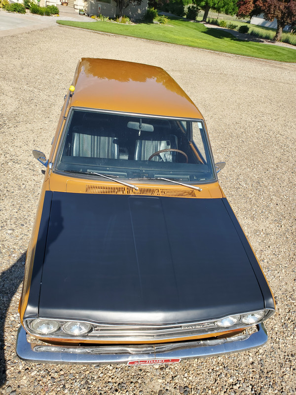

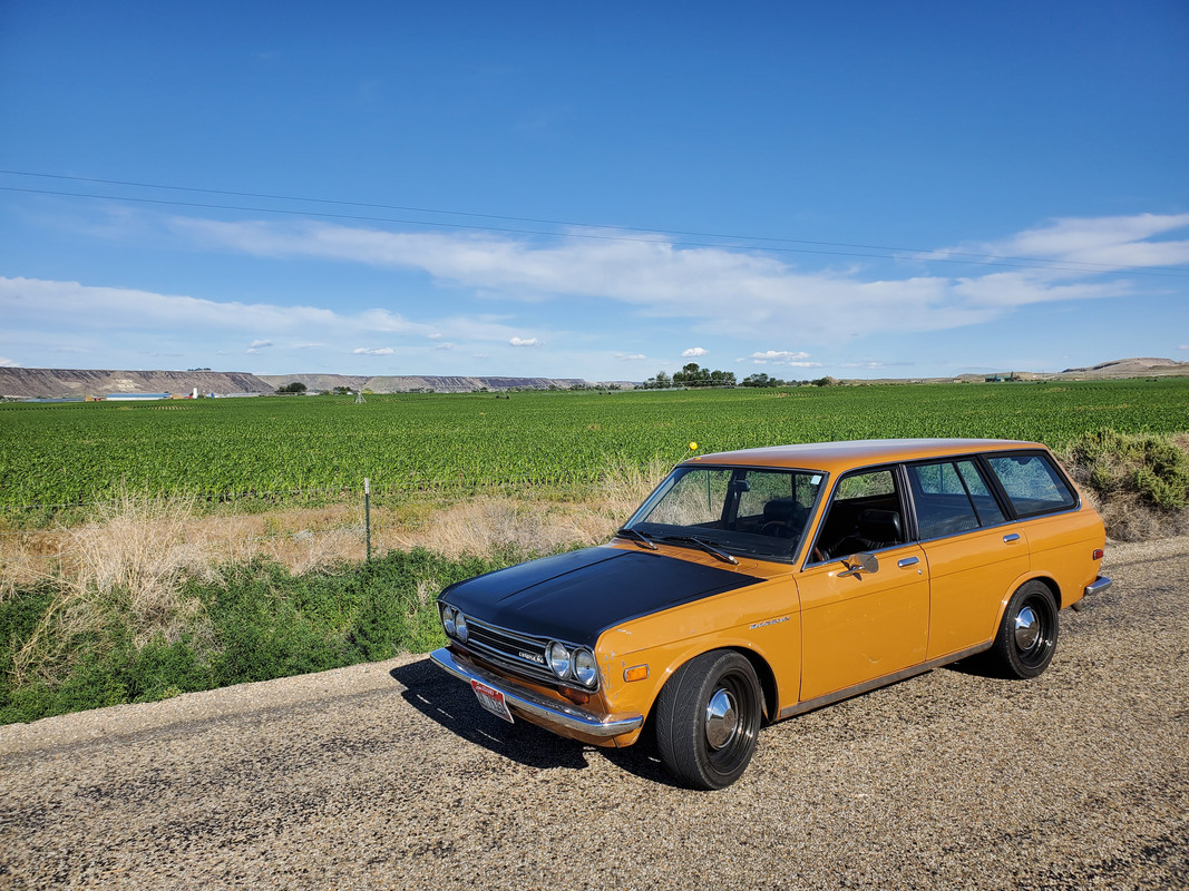

In the end I think it is a personal preference thing, you have a black theme going on(black hood and posts), but the bumpers are still chrome, also I believe them are truck hubcaps so it is really personal preference, it looks good either way in my opinion.
You also had a chrome strip for below the door???

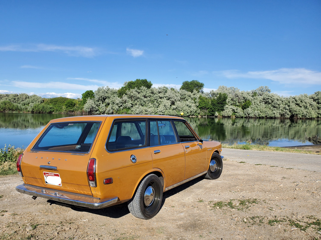

Good eye. I had used some glass glazing tape to attach those but the ends were working loose so I pulled them. When I went to my brother's shop last week he gave me some 3M tape made for that sort of thing. I reattached them and added a countersunk screw to each end.
I also decided to go ahead and install the caps. I made a notch in each one opposite of the drain hole so I'd be able to get the pry end of the lug wrench underneath. Put a little piece of electrical tape in that spot too. Last thing I did was bend the tabs in just a but so the caps would actually pop on and off.
Gave the lug wrench and spare tire tool a fresh coat of paint.
Once I had it all back together I took it for a 20 mile loop and snapped a few more pics. Ran fine, as usual. It was less echoey but didn't make the windows rattle any less.
You wouldn't know it from the photos but it's 95* out there.
I think I like it better with the caps when the rocker trim is in place but I like the bare wheels without rocker trim.

looks great with the caps and lower trim. Whats the trim from ? The trim looks wider then the stock ones.

It's just aluminum bar stock that I profiled, sanded and polished.
