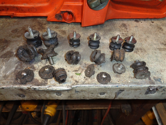

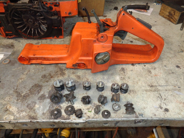

Here is my Husqvarna 266 W, the first photo is of the broken rubber parts in front of the handle/tank.
This is a close up of the new and old rubber parts.

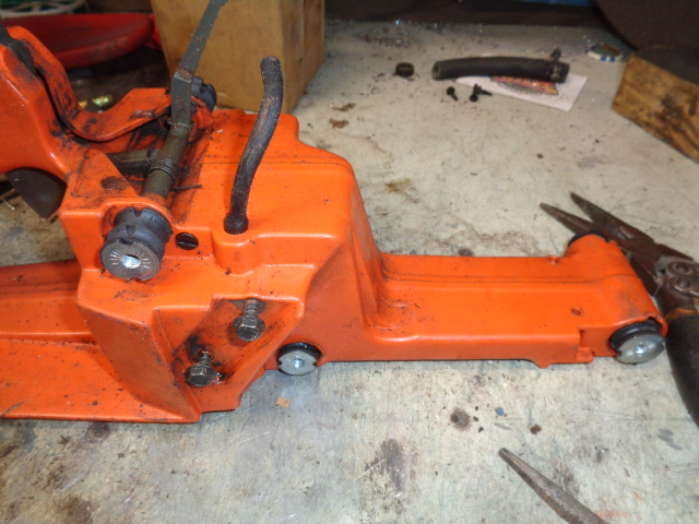

And this is of the handle/tank with the new rubber parts installed, the guy at the shop said the engine assembly would not go over the handle/tank with the 2 upper mounts mounted, it slid right over the handle/tank without any issues, they consider this chainsaw a "frankensaw", they say it was never put together this way at the factory with then 2 extra mounts, they call them anti-vibration mounts.
I did fire it up in my backyard but did not use it, it appears to work fine although it is really loud, I am now looking for a new muffler.

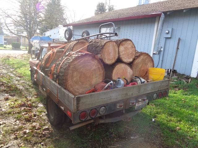

I used my chainsaws today, the chains were not sharp on either of them, so once the 24" ran out of fuel I used the 32" until it ran out of fuel, then I put the brand new chain on it and it went thru a 32" log almost like butter, its not a race chainsaw but one has dreams when a new chain is installed, there is one more load left and I believe that is all there was to be had unless the cousin drags some more logs in from somewhere I do not know about.

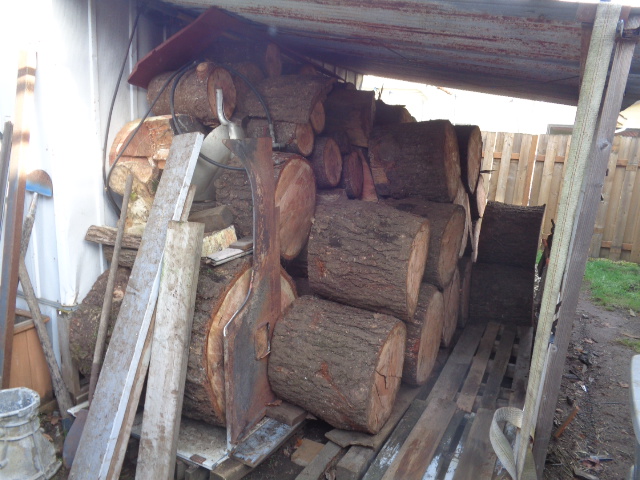

Here is the load today, I did not really fill it up as mentioned as there is only one load left.

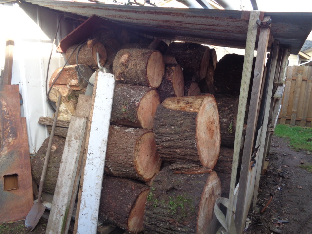

This area was for parking my small tractor, but I needed somewhere to put the Fir firewood pile, except for about 10 large rounds it all fit in this area, here is where I was this morning.
And here is it almost completely full, I do not know exactly how much firewood is in this area, I suspect it is close to 6 cord.
The maybe 10 rounds left are all 32" or larger, so far I only have had one piece of wood drop not very hard on my right foot where them bone on bone joints are, it hurt like hell but it appears to have not made the foot worse(happened a couple weeks ago), so I guess I am lucky, I have a couple years of firewood stored now.

Also , looking at those rounds loaded in your truck , Respectfully , You must be one strong SOB...mechanical assistance or not...

I am not as strong as I used to be even a few years ago.BLUE wrote: ↑Fri Dec 15, 2023 10:31 pmChimney fire...Thats axtually super scary. I hate to admit it , but i only clean ours out 2x a season. The cap usually gets cleaned 3x a season. I actually bought axlong multiple extension chineny s w e e p off amazon for $60 to clean majority of mine from the bottom , then when in on the roof i can finish from the top/clean or replace our cap as i see fit. Mostly o a k or a l mo nd.
I get them on the truck with a board ramp/ramps, I am as careful as I can be with something that weighs likely 500lbs plus, I put the rear axle in a low spot to get the rear of the bed as low as possible, smaller rounds I only need one board as I can roll it up a pretty steep ramp, but the large ones I put a small round on the ground and the board on the bed/round, then I use another board between the round and the ground, this makes the ramp less steep, then I slowly roll the big rounds up the double ramp, I am very careful, the last foot or two is the hardest as the round is chest level by then and all I can do is push it with my arms while trying to balance it on the 2X6 board, rolling them off the bed is easy.

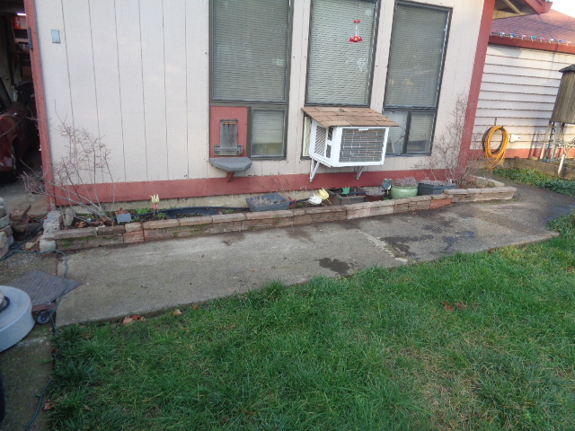

I picked up some free brick wall pieces that were knocked apart with a sledge, I made a mini wall for my front entrance walk, I was hoping to make it 4 or 5 bricks high, but it was not to be, 2 bricks high and the top bricks(3 bricks high I guess), I had just enough to make it the length of the walk, there was not enough to do the 3' sides, I will use something else.

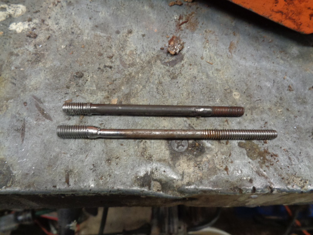

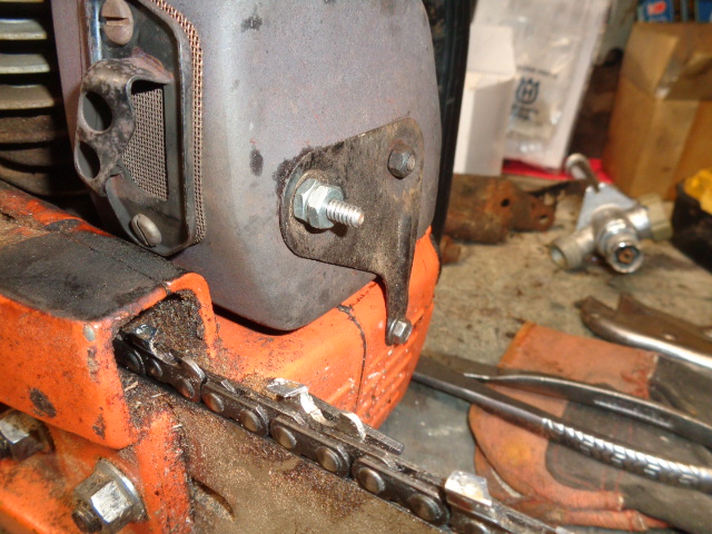

I guess I never took a photo of my Husqvarna 61 when the muffler was kinda jury rigged on, I have mentioned the exhaust stud stripped out nearest to the chain, but threads go deeper into the head, so I can screw the stud deeper into the head but then it is not long enough to stick out of the muffler to put a nut on it to tighten it down unless I don't screw the stud all the way into the head, I also cannot put the muffler brace on it, so I have been tightening it down on that side, then putting the brace on over the nut and then putting the nut on the other stud and screwing the other bolt into the housing holding the brace in place, it bugged me a lot that brace sticking out at an angle, and I could not find anyone that had a longer stud.
This morning I decided to make my own stud, this is not an easy thing to do because the head threads are 6mm, while the shaft is smaller and so are the threads that that have the nut that holds the muffler on, the holes in the muffler are too small to fit a 6mm threaded shaft thru and the sleeves are too thin to drill them out to except a 6mm shaft, so I cut the end of a threaded 6mm bolt off, I found a long thin bolt that fit in the muffler hole, I cut it to about the right length and welded the threads onto the smaller shaft, it was very hard to get the threaded section on the smaller shaft straight but I did the best I could, then I ground everything down until it would work with the new stud installed, you can see the shaft is slightly out of center on the threads.
As you can see in the photo below the new longer shaft is below the stock shaft, the upper stock shaft has a lip where the threads end, I could not replicate this lip, that lip centers the exhaust gasket and muffler on the shaft, so I made the threaded section slightly longer so it stuck out about the same distance as the lip, I had to slightly ream out the muffler holes so it mated to the head properly as the exhaust gasket is very thin, I succeeded.
Below is a photo of the finished modification, the threads stick out farther than the stock stud that the threads are good in that hole so I just use the stock lock/jam nut, I double nutted the new stud with a lock washer between the nuts, the threads sticking out do not appear to get in the way of anything as the spikes that dig into the wood when cutting are longer, so for now I am not going to cut the extra threads off.
One thing that does concern me is if the weld breaks off and that would leave the threads in the head hole, I did not tighten that stud down really tight, I started the chainsaw without ear plugs or the ear muffs and it was not that loud. I stuck my fingers as far as I dared around the gasket area and could not feel any exhaust leaks, this is my backup saw, but anymore I use the one with the sharpest chain, they are both big to me.

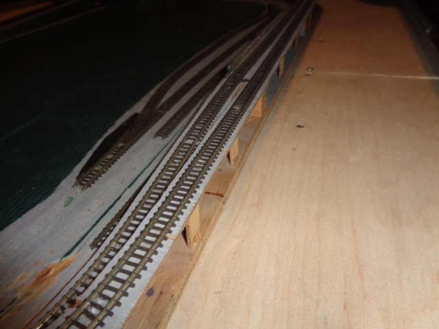

Back around 2005 I built a coffee table train, I suppose I might have a photo somewhere of it but that was when I did not have a computer, I inherited this from him when he died, it has been in the closet since then as I was too busy to deal with this kind of thing, if I had free time I was working on Datsuns.
Recently I pulled it out, the tracks were dirty and it would not run right, as it had tunnels that I could not get to the tracks to clean them, the coffee table was not that nice either, it was very small and had 2 completely different train circuits(2 different trains blended together), I bought a much nicer coffee table that was larger over 10 years ago but did nothing with it, well I got all of it out.
I do not recall, I do not appear to have a before photo, in the photos below I removed the tracks on both ends and sliced the drop in track in half, you can see where it was cut down the middle.

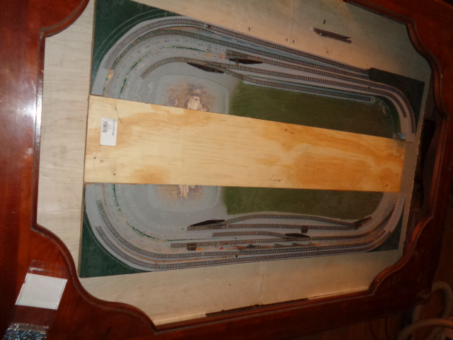

Here is the coffee table.
Here the drop in track assembly is sitting in the middle of the coffee table hole, it is too small to be in there by itself this way and that is why I cut it in half.
Here it is with a 7 inch piece stuck in the middle to make it fit the hole better.
In the photo below you can see I cut out the pointed corners and made them round, I did this for a reason.
I will rebuild the drop in track assembly and add what it needed to connect all the tracks back together, I need to add plywood to the upper levels to mount the new pieces of track, once all that is done then I will add new drop in pieces on all four sides to make it level at the base level, I will still be able to remove the drop in center part(green part), then I will add a 3rd stand-alone track design outside of the green part for a 3rd locomotive that could not make the corners on the smaller drop in as the turns were too sharp and it would derail, I have yet to design that part yet, I am still searching for 3/32" plywood for the upper level, then I design what I want and draw it on the surface, then I use either a jigsaw or a band saw to cut areas that will be bent down so I can make it multi-level, this outside track might have 3 levels, the only drawback is it is hard to clean track when track is under the level above it, 3 levels might be too much of a pain, I do plan on having the outside circuit have a piece of track enter into the center of the middle drop in section, this might make it not a "drop in section" anymore, more to come as I make progress.

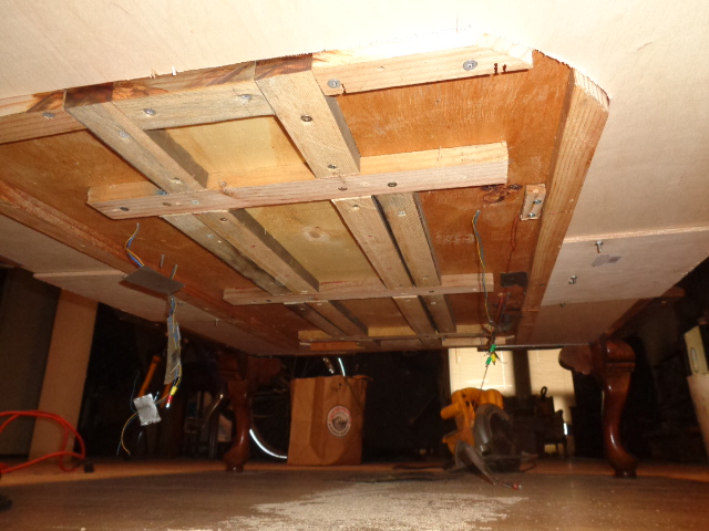

I made some progress on the installation of the drop in part, I cut the hole in the base I made and dropped it in the hole, I am doing it this way because I want it as low as possible so when I make the part around the drop in part that part will step up as it reaches the sides yet nothing will hit the glass cover.
Here is a photo of the bottom.
I have 3 more tracks to connect/put back together and then I can plug all the wires back together and test it to make sure it works properly, then I will start building the sections around it.
