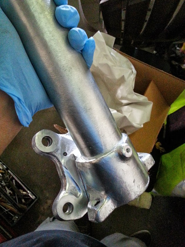

Yeah so I was going to instal my "ZX" coilovers today but I ran into a bit of a problem
I got my 280zx rotor in the mail, look at this beautiful thing
Anxious, I run to the shop to install these things. but weighing them in my hand I notice that they are HUGE!
So I compare them to the "ZX" rotors
hmm wait hub looks a little weird
Wait they look like stock 510 struts
What the P/N on them
ok looking at the spindle..
FUCK.
FUCK.
I was hoping to pull my front wheels in, looks like thats not happening without camber plates. IDK about those brand new rotors either.
