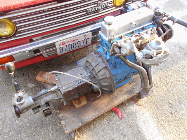

Well I bought another MG engine, this one was supposedly rebuilt 5000 miles ago, the guy selling it was converting over to a CB1000 fuel injected engine, going from 65hp to 170hp is likely going to be nice for him, he also was talking about turbocharging it to bump it up to 225hp, and he had the hardware there to do it, it was a widebody MG Midget, I never seen one of them before, forgot to take a photo. :(
It's a single SU version, I need to lay it over on its side and put a new oil pan gasket(got it with engine), then mount it up on the engine test stand, put all the fluids in it and see if it will fire up, I still have other stuff to do though, I didn't get the electronic ignition brain or coil with it, although he said he was going to look for it, but I can remove the setup on the other engine and put it on this engine, if it sounds good, this engine will go into the MGTD and the other one will be a backup.
I was told the tranny that came with it was gone thru at the same time as the engine, but who really knows, but I did go get this from the guy at his house, so I know where he lives, and I did check the end play on this one, it felt fine compared to the other engine missing it's thrust washers.
I will have to go to Parkrose hardware for the oil pan bolts, he could only find 4 of them, I also need gear oil for the tranny.

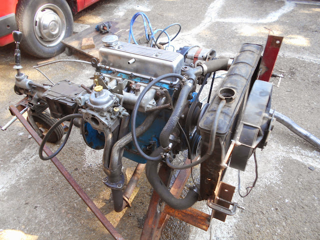

I started this engine today, it doesn't run as good as the first engine, but I suspect that it is the difference between an old SU and a new Weber carb, it doesn't idle as good as the Weber, but otherwise it sounds good.
All the photos are of the engine running.
It has plenty of oil pressure(60psi when started up), the photo below is of it warmed up at an idle, I am not sure if the temp gauge works right though, it was in the white(hot) the whole time, but it didn't seem hot to me, I could put my hand of the radiator without burning myself.
I ran it for over an hour, it vibrated quite a but, and I am thinking that it might have a lumpy cam in it, it just didn't want to idle smoothly, but it still would idle at quite a low RPM, just not smoothly, and it readily revved up.
I did put a fan on it later in the day, it had the electric fan running, but I put the stock fan on it trying to lower the temp on the temp gauge, but it really didn't change it at all.
I believe I will have to change the water pump out on this engine, when I first added water, it was leaking around the shaft or vent hole, but after it warmed up it quit leaking.

DRIVEN » Sun Apr 19, 2015 7:02 am wrote:I never did like the way those Strombergs ran. My brother's Volvo had dual Strombergs on it when he got it and we never could get it to run right -- or smooth. Slapped some swap meet SUs on it and it was night and day better.
I have lots of SUs around here, but they are jetted for a dual setup, so each one is made for about a 1000cc, this engine is a 1500cc, so I don't believe it will work right unless it is re-jetted.
It seems to run good except when it comes to the idle. maybe it has something to do with that coolant activated automatic choke on the side of the carb, I thought it was a fuel regulator, but one of the guys on the MG forum informed me different, after it warmed up is when the idle got weird, but when I first started it I was worried about other things than the idle, so maybe it was fine when it was cold.
I wonder if that other outlet above where the fuel line is connected is the vent for the bowl, I will ask on the MG forum.
Well it runs, and had no weird sounds when started.
Every time I set one of these engines up on the test stand I get it 180 out or even worse, but I am able to get it right within 3 trys.
“The difference between genius and stupidly is that genius has its limits” Albert Einstein
