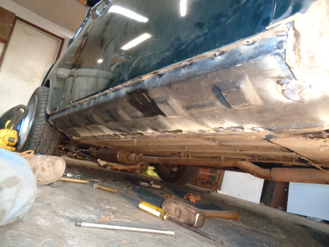

This is how far I got today so far on the Mini.
All the edges are laying out flat against the existing floor panels/tunnel/ect; I have one area on the right front fender well that needs more repair.
Everywhere you see a screw will be turned into a spot weld plus a lot more of them, I believe that is the way I am going to attach this panel to the car, this panel appears to be made to cover the existing floor board rather than replace it, it really is not very thick, I will put seam sealer over all the edges when I am done installing it like they did when they built it at the factory.

Welp, the floor pan has been installed, I drilled the new floor pan and installed it and made marks where the holes were, then I removed it and sanded off all the marks to bare metal I cleaned everything up and painted the old floor boards with POR15 except for the bare spots as I need clean metal to do spot welds, then I put the floor pan in position with the screws and started making spot welds by welding the hole shut to the floor pan below it, I had to put a jack under it and force the old pan up against the new floor pan, but that wasn't that hard to do.
At first this morning I removed the flares and then started on the sill/rocker, I kept having to cut away more and more metal as the new sill/rocker would not fit into position, the sill/rocker is made to cover the old sill/rocker, well it turns out I am at least the third person if not the fourth to deal with this sill/rocker, I found an old sill/rocker under the rusty one on the outside, I thought someone had just repaired the original sill/rocker, once I seen what was going on I had to get the replacement pan in position before I could really do anything else, I am learning way more than I care to about these Mini's.

Well I got the front fender well area done inside and out, but I have not put the sill/rocker in position yet and it connects to the floor board on the outside also front also, but here is what I did before a guy showed up and we talked about diesel stuff for 4 hours.
I did do some stuff after the guy left to start positioning the sill/rocker, I cut all the vents off and ground the very top of the sill mount area flat from front to back, the paint is all gone in that area.
There is a piece sticking down that is supposed to be a jack point, but it appears to be in the way of letting the new sill/rocker settle into position, it git late so I stopped and made dinner, it is hard to see in these photos below, but I may have to cut it out like I had to do in the front, I will likely have to make new jack points.
I bent the sill/rocker a little to make it fit better, but I might have went a little too far, My plan is to drill it also to spot weld mount it, it will likely be ready tomorrow to mount, but it is going to need some modification to the front as when I put it in position the front is about and inch to far forward, I don't think that floor board/wheel well area has been pushed back from a accident or a tire de-laminating and slapping that area like what happened when a re-tread came apart in the 521 work truck on the freeway one time, but something is up, maybe the last time they did the sill/rockers they changed things, I will know more tomorrow.
