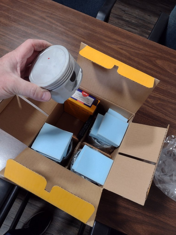

Oh snap! I was searching on ebay and found a 1 mm over (.040") piston set from NPR (Nippon) for 100 bucks shipped, booyah! I'll bet someone has been waiting to get rid of that set since most rebuilds don't go that far out.

Pistons ho!
