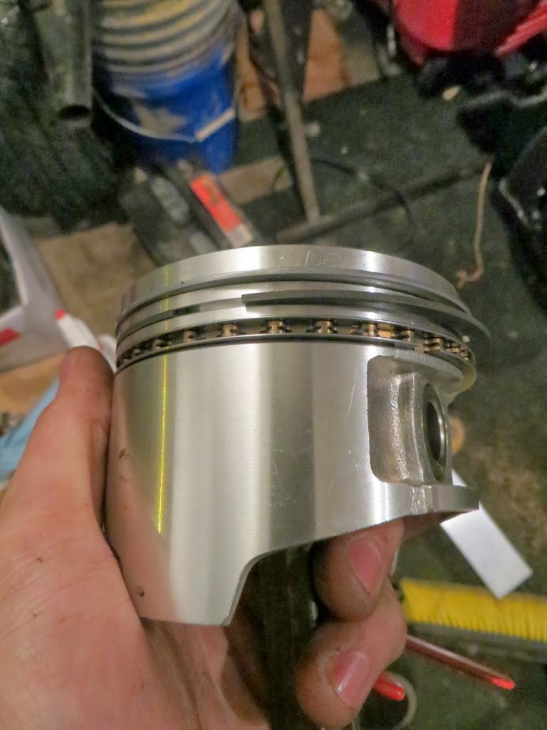

New pistons are now pressed onto the rods, also got the polished crank back. Ended up using a different one I had due to some scouring on one of the journals.
Almost time for some LZ :thumbs:

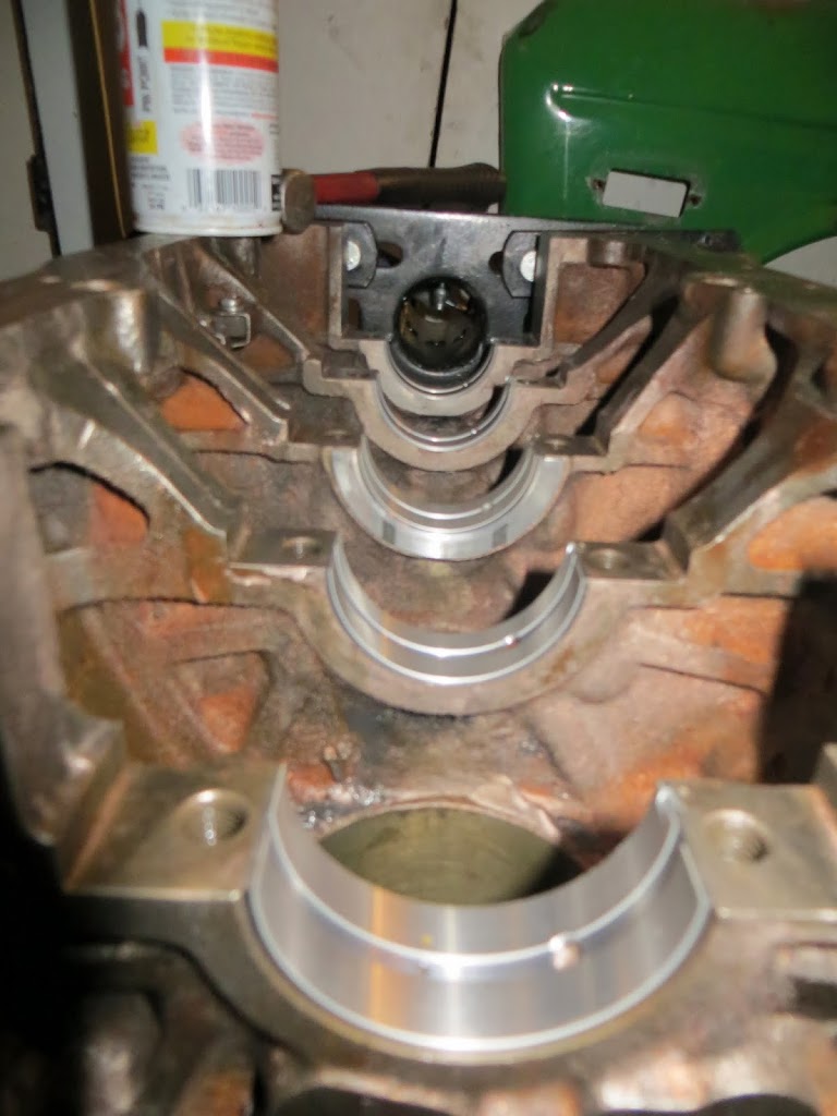

Honed the block last night, got to the bearings and I forgot the assembly lube. Hopefully tomorrow some work will happen.

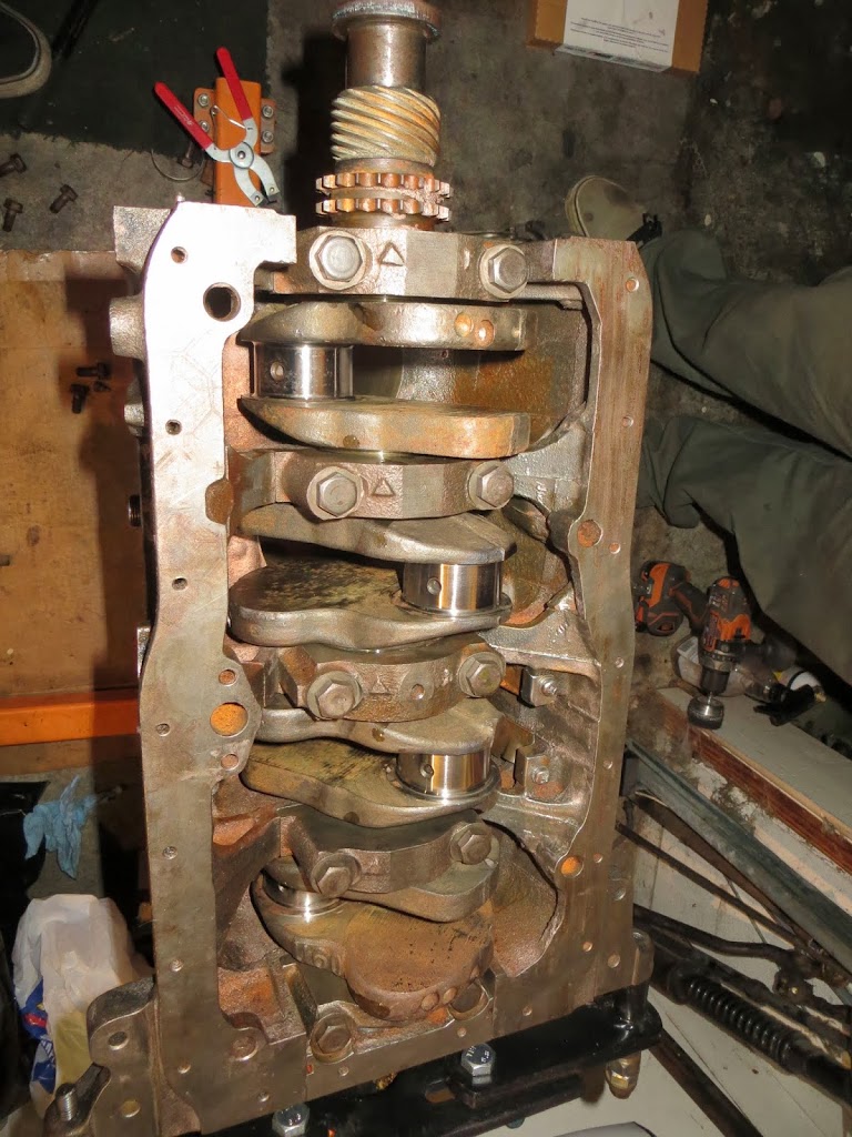

Got the short block together tonight :D. Jacobs gonna try and paint the block tomorrow, and i'll be going back Tuesday to finish the rest...
Cleaned the head up and the KA oil pump

We used the same assembly lube as I did on my L19, 50/50 of STP oil treatment and engine oil.
Plastigauged the bearings and all came back in spec, right in the middle.
Rings were checked for gap, and all came back in spec. (My L19 had like 3 rings a little tight). Rings went on. and then compressed. I managed to get all 4 pistons in first try. I was all "I dont know how this is going to work..." and its in.
Pistons look good in the block.
And some higher resolution photos.
Everything is tor
