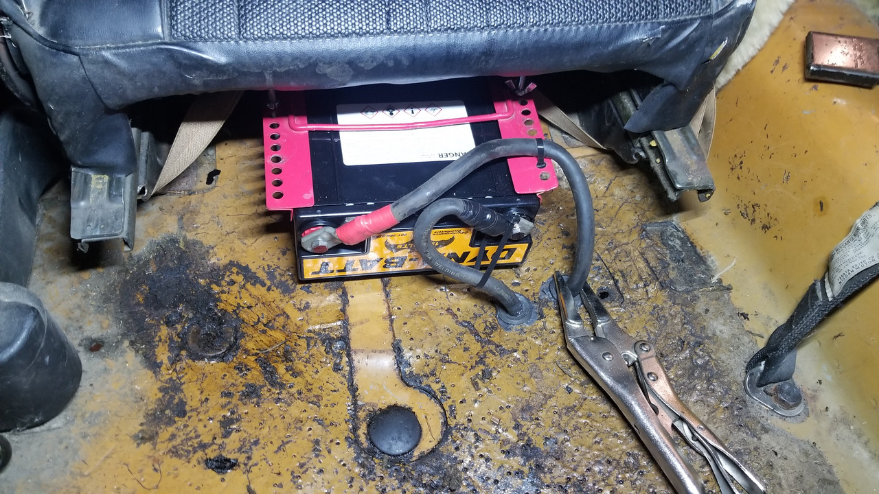

Not much progress. I did get the battery relocated. I ended up ordering the same one we used in my brother's '36 since it was so compact. My original intention was to cut a recess in the floor under the back seat but took the easy way out and just put it under the driver's seat. Plenty of room with stock seats at stock height.
There was a pair of long cables left over from my dad's Nautique project last winter so I was able to repurpose those.
The engine bay is still gross but the extra room from moving the battery will be really nice as this engineis noticeably wider than an L16.

What gauge did you end up using? Any issue with running the wires under the car to the battery?
I get that the fuel lines do the same thing, just big electrical cables doing that makes me a bit nervous, probably unreasonably so. I think I might copy this idea as I have been having a similar issue.
Re: Just another car I'll never finish.
Posted: Tue Feb 05, 2019 6:06 pm
Probably 2/0(?) I'm guessing. It's really fine strand like welder ground lead cable. I didn't even think to take pics of them under the car. They run through a couple rubber grommets that are siliconed in place then are parallel but not together. Seems to be more than enough battery for a 4cylinder. Small too.

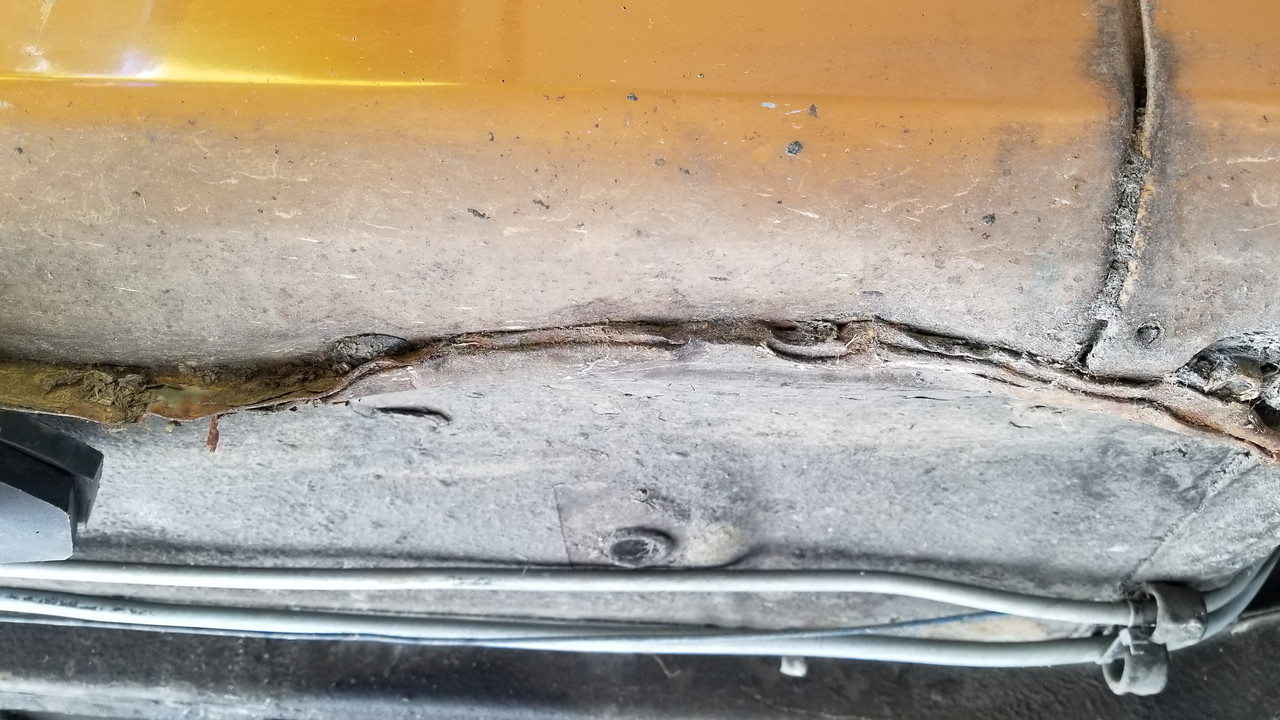

Went over there to grab some stuff and snapped a quick pic of the underside.
With the driveline, crossmember, exhaust, and floor brace hanging lower it seems well enough protected unless you were to high center on something pointy in just the wrong spot.
