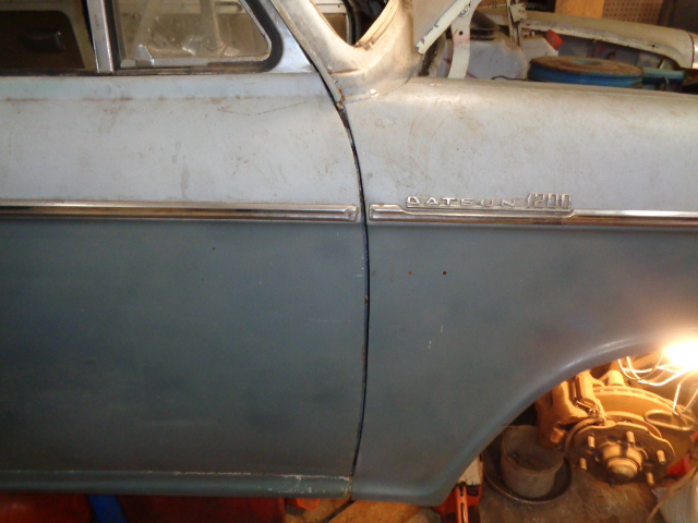

Does it look like it has a two tone paint job on it?
It looks like the bottom half is slightly darker than the top half.
