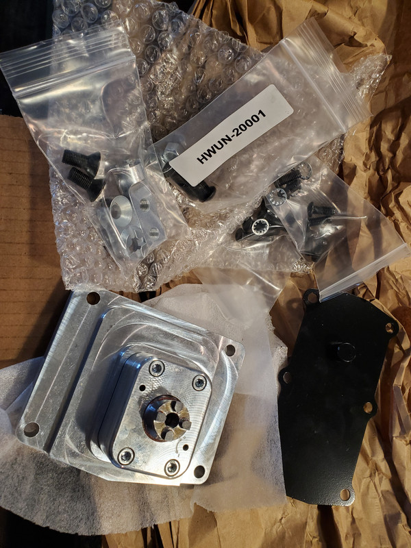

Did the mid-shift conversion today. Started with disassembly of the mid plate and standard shifter. Punch out the roll pins and remove the lugs. Leave the lower (rear) one out and reinstall the other three upside down. The new rear plate has a post to keep the rear rail from floating around.
The new shifter has a pretty clever splined arrangement that lets you put it in 8 different positions. All buttoned up.

OK, so originally the shift lever was in the plate with 6 bolts holding it on, and one could reverse that plate to move the shift lever forward or back depending what you wanted, you bought an aftermarket shift lever kit that moved it even farther forward in the plate with 4 bolts holding it on, is this correct, was the shift lever too far back?

That's exactly right. I could have probably been okay but wanted it more forward. It'll be very close to the same location on the floor as the original flathead shifter.
BTW, when I bought this it had a '39 transmission in it with Zephyr gears. It'd run up to about 70mph in 2nd gear. I promptly broke the case slamming a 1-2 shift while drag racing a coworker in his Mercury Capri. The only salvageable part was the shifter, which I've saved all these years.

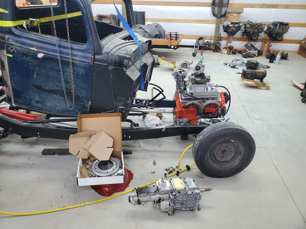

This was the engine that was in the truck when it got wrecked. I built it while I was going to Vo Tech school and originally planned to put it in a 240Z. It found it's way into my pickup for a couple years then after the accident I ran it in the Smell Camino for a little while until I broke a rocker stud. I don't remember how long ago that was but I'm thinking about 18 years. I had the heads machined for screw-in studs, put it back together, and wrapped it in plastic. Almost 7 years ago I dragged it out for a fresh coat of paint and it's been waiting ever since.
Here's a little catch-up on the events leading to the start-up last night. Started by hooking up an oil pressure gauge and primed it for about 10 minutes while rolling the engine over. Then I checked valve lash, which was interesting since I couldn't locate my feeler gauges. I ended up using a piece of .030 welding wire.
Next, I moved on the the ignition system. The distributor that was in it used to have a Pertronix kit but it got robbed for another car. I replaced it with an Crane system and used it in the Smell Camino but it did some weird stuff so I decided to use another Pertronix. I left the Crane distributor intact and grabbed an old points distributor from the stash.
Hotwired for bench test. Nice and sparky.
I was expecting the carb to be filthy and need a full rebuild so I ordered up a cheap kit last week. To my surprise, it was really clean inside. The accelerator pump was hard as a rock so it was the only thing that got replaced. Once it was on and running, I found the adjusters seeping so those will need attention.
It didn't fire right up like they do on TV but didn't really fight either. Some drunk idiot forgot to cap the PCV port on the back but after that it ran good, considering how long it's sat.

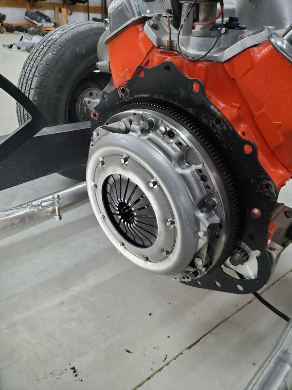

I pulled all the parts and boxes out of it and got it ready to blow apart. Then I adjusted the coilovers so that the tie rods and lower control arms were level. Ended up raising it about 3.5". Before I started the jack wouldn't fit under the swaybar.
Then I went to work.
Just waiting on a new flywheel then the TKO goes in and I can measure for the driveline.

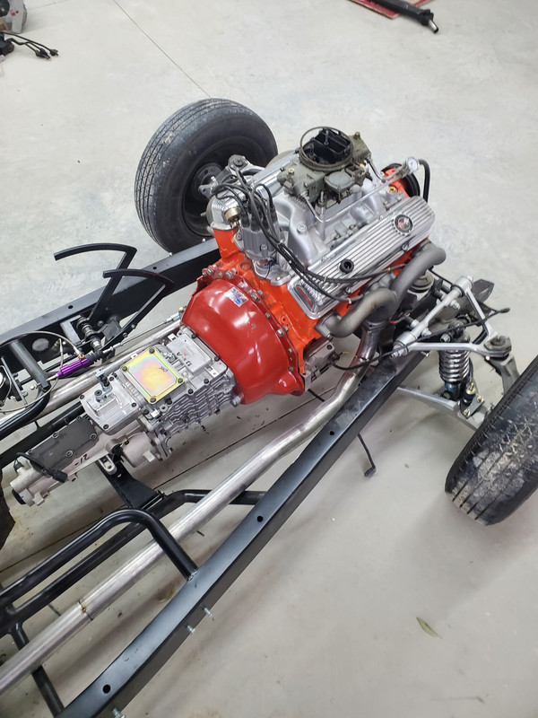

Not much has happened here this year. I did some patch panels and filled a bunch of firewall holes. The back of the cab was bowed quite a bit compared to the floor so I did a Frankenstein tummy tuck.
It's in sealer and just sitting on my trailer waiting for my brother to make space at the body shop.
After I put in the TKO600 the driveline was too long and the yoke was wrong.
I ordered up a new radiator too. Not cheap, but really nice.
And a cheap fuel cell. 19 gallon, which should be a $200 fill-up by the time I finally drive this thing.
