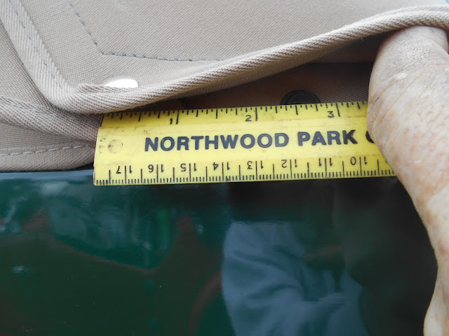

After looking at this installation for a while, I believe that the back is off center maybe an eighth of an inch, but I also believe that the top is not symmetrical either, it is an aftermarket top, made by someone not affiliated with the makers of the car or there vendors.
My issue is that on the passenger side the top comes 2 inches forward from the wood mount trim board along the bottom, while the driver side it only comes 1 1/2 inches forward, now one can only see one side at a time, but the reason it bugs me is because when I mount the rear side curtain frames without the covering material on them, it's obvious that the sides are different, but as I said, one can only see one side at a time.
That said I have considered releasing the driver side rear, pulling on it hard and re-attaching to it to stretch it to the same position as the other side, but I am a little worried that it might cause wrinkles somewhere, and when I do get that extra half inch at the end, where will that extra material on the side above it go as it is not tight in that area on either side, right now they basically look the same wrinkle wise(no wrinkles).
I am thinking that maybe I should leave well enough alone, it looks decent the way it is.
I have not talked to Todd yet about making the side curtains, I figured he could likely match the material, but before I do that, I need to be sure that the car will make it to his house and back, so I guess I should get back to work on the mechanical parts of the car, I can and have drove this car at least 10 miles so far, but it got very warm, but I will admit, it was hot outside also, very hot outside.
EDIT
Well I just went out in the garage and released six inches and pulled it down and tight and stapled/screwed it in position, both sides are almost the same now, I am going to live with it for now, I think it would look great except the welting pushes it out, if the welting wasn't there, it would likely hang straight down.
The welting also pushes the front out a little.
Right side
Left side
Maybe I am just to picky.
EDIT
Right side
Left side
