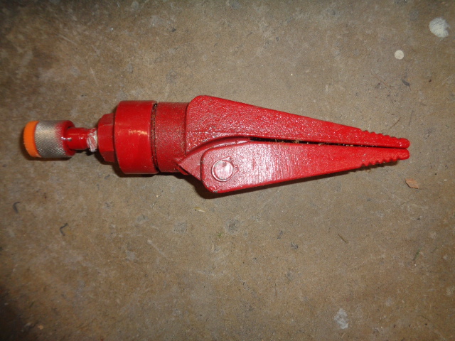

I have a porta power setup from Harbor Freight, but the spreader thing is too thick to fit in there where the dent is, I don't really want to go buy a welder thing that welds a rod to the metal and then a slide hammer connects to it and pulls the dent out, anyone have any other suggestions?
