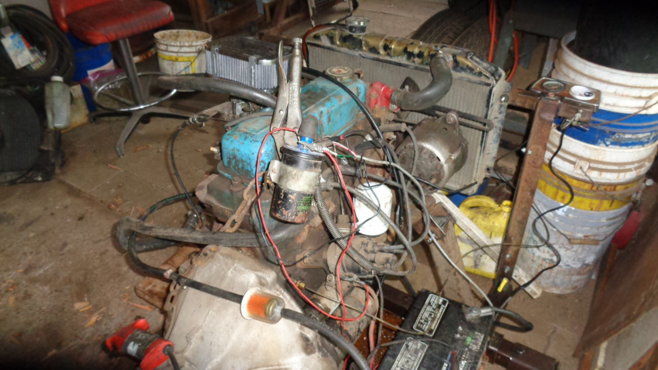

I put the A14 on the engine stand with a 5 speed connected to it, I started it and it sounded like the transmission was howling, the clutch cover/disc were not installed when I bolted the transmission up, so being the only part of the transmission touching the crank was the pilot bearing and it continued to howl when I stopped the output shaft from turning with my hand I removed the transmission, what's hilarious is I was trying to figure out how to support the engine without the transmission connected to it, well the thing doesn't need the transmission to support it, it just sits there even while it is running without moving any transmission at all.

I put the J15 on the stand and got it running again, it has a Weber and appears to be alright, it has 60psi oil pressure cold, and around 30psi when warmed up idling.
The coil got a little warm, when I tried hooking the tach up it started jolting me, so I wonder if it is an electronic ignition type coil, but I don't know how to figure out which type it is, I am sure it will smoke the points if it's the wrong coil.
I am not sure the tach is reading right either as it idled best at 1500rpms, but it didn't seem like it was that high to me, I git it down under a 1000rpms and the fan was barely turning.
All my other engines are on stands of some kind, so was the J15 but it was a cheesy stand that was not the greatest for running the engine, this stand works great and the tires don't go flat. :lol:
