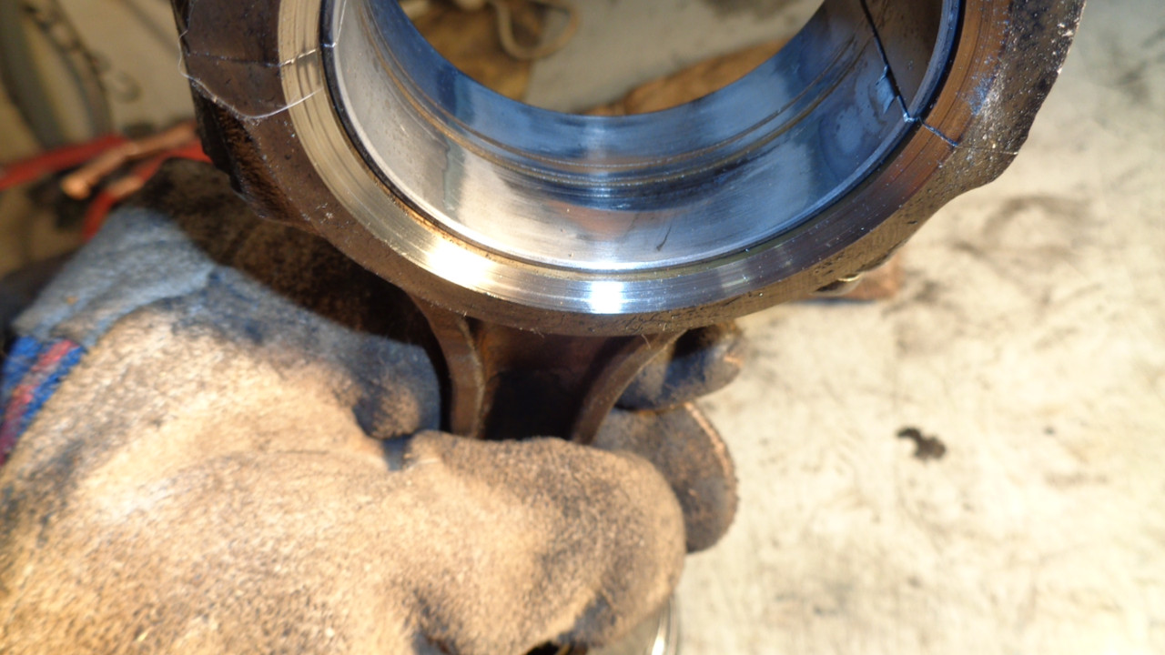

#1 rod bearing side looks the worst and it has lines in it, #4 is the next worst, #2 just shows a little brass color, and #3 the one that came up short of the deck is the best, it barely has any brass showing, the end cap side of the bearings all look good except for #1 that has lines all the way around.
#3 definitely came up 1mm short as #2 right beside it was flush with the deck so I did not have the crank in a different position.
I could not move these pistons sideways in the bores, they are tight in there, the cross hatch markings in the bores make me think it was either rebuilt or maybe a piston was changed out in the past, if SD22 rods are the same I have extra rods, I will have to look in my parts bin although I doubt they will be the same as they are 3 main bearing cranks and my SD25 engines are 5 main bearing cranks, but I will look anyway.
#1 bearing
#2 bearing
#3 bearing
#4 bearing

I think I have an issue, does this #3 rod look bent to you guys, it looks bent to me compared to the SD22 rod in the background.
The SD22 rod itself in the background of the first photo looks the same but the end cap is not the same, my scale for weighing food is not big enough as the rod maxes it out so I am going to have to buy another scale to weigh the two rods to see if they are the same weight, I just tried the SD25 rod end cap on the SD22 rod, it fits and is the same width, but it is larger round, so I don't see the point as the SD25 rods are going to be heavier.

Yea, that rod looks bent to me. Bent sucks but may run fine. Twisted is a different matter.

I am not going to run a bent rod in anything, and that piston comes up short of the deck also so it doesn't build up the compression it should, 1mm is a lot and the compression in that cylinder could be way down and that could be the reason it smoked so bad.

Yup. Looks bent to me too.
