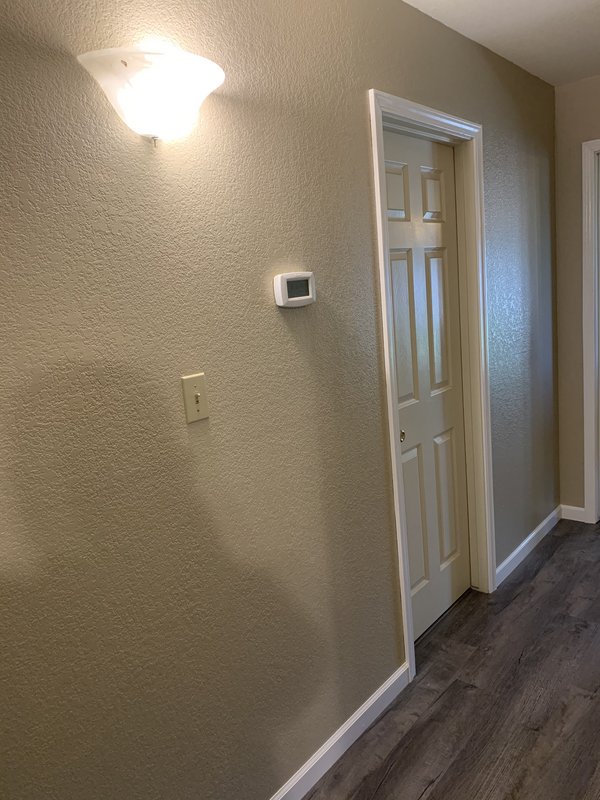

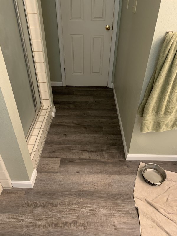

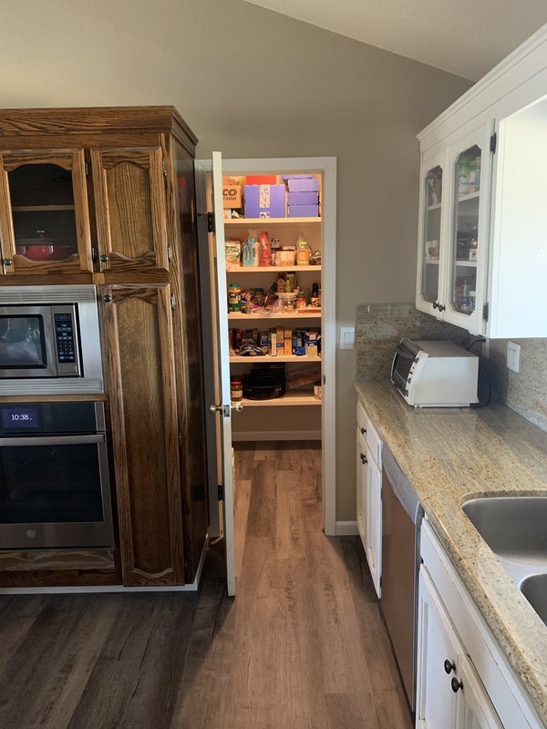

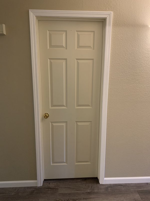

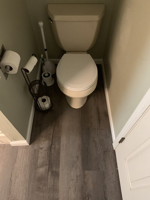

New molding and door casing s (not inside bedrooms or bath). I didn’t go with the more expensive stuff for now since there’s a lot going on. None the less , this is a clean look.
More things need paint inside the house...basically most places. Meh...lulz

Looks damn good sir. I think you’ll be satisfied with that product. It’s almost impervious to pet scratches. What are those? 7 inch wide planks? Makes it go pretty quick when you’re in a big open room. Good on you. I think he did a fine job. Did you undercut the door jams or cut to them?
I appreciate that Tater ! Yes sir 7” planks. Funny thing...the wood floor that I took out was a lot taller than why I put back in. Didn’t need to undercut much in many places. Some places I cut to , then hid any sins with the casings/molding per usual. I’m gonna have to shave/plane the guest bathroom door that leads from the bathroom directly outside.

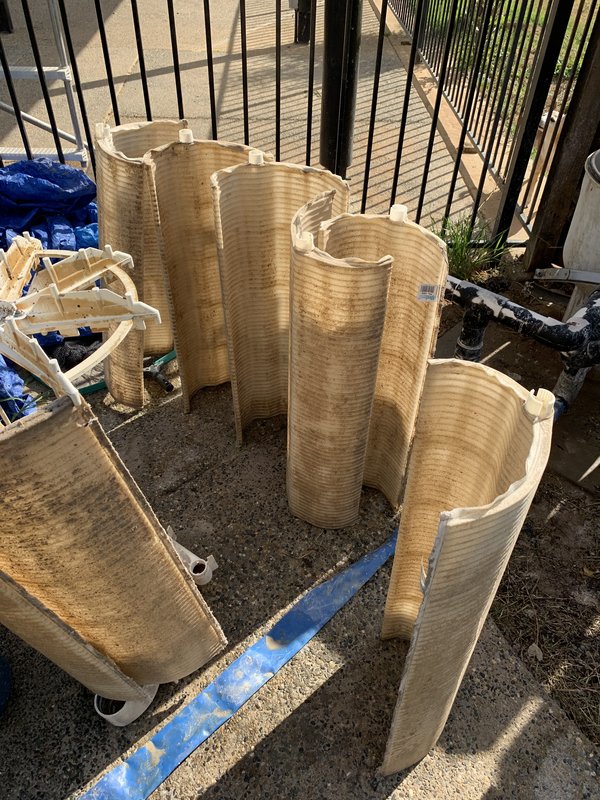

Pool time. Taking apart this lovely nasty filter. Looks like previous owner didn’t do maintenance for on this thing. First time I’ve been through the system , and 1st time I’ve dealt with a variable speed pump/this type of filtration. Weird.
Before
Apart and clean
Assembled and after
New pressure gauge and bleed valve. Old were no good.

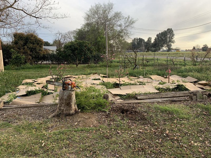

Not much of an update. You can’t see it looking down this side of the property , but spraying commenced for herbs to be less of a PIA to me. I’m gonna have to try to figure out trimming that palm tree if I keep it.
Cut down some dead stuff , and transplanted all of these younger trees from our last home to here.
Cut down more dead stuff

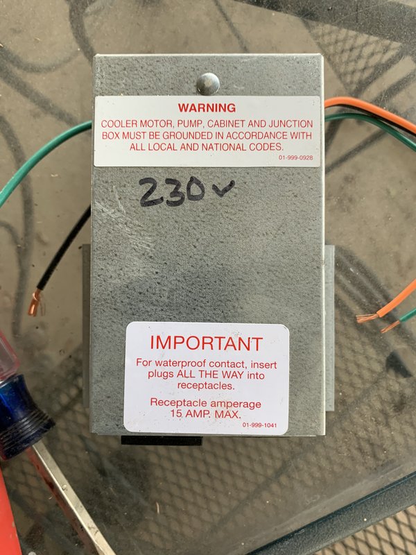

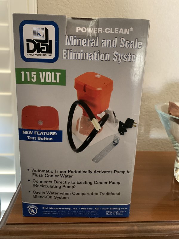

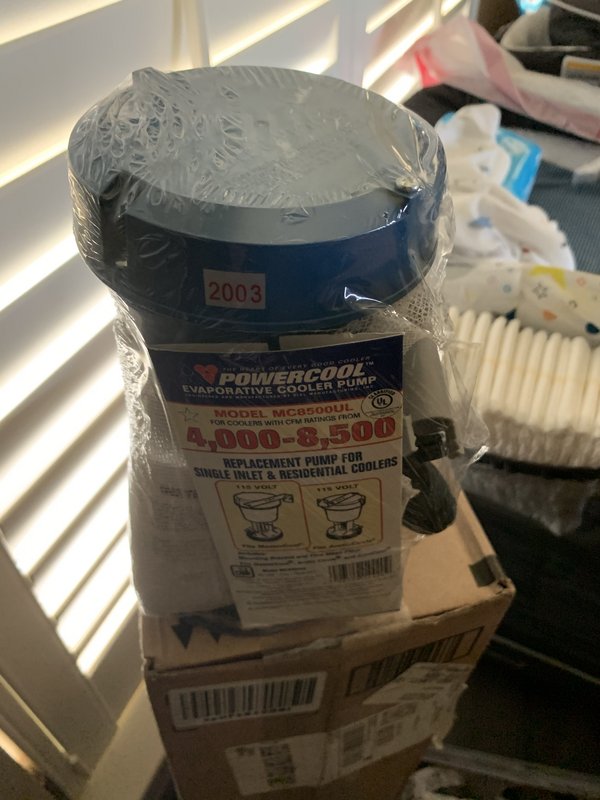

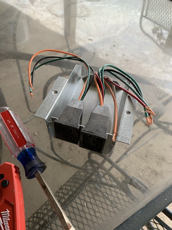

Got al of those parts ^^^ (above post purge pump , feed pump in )in and working 100%. During that process of replacing the electrical portion...literally found that the neutral wires literally slipped out causing things not to work. I originally looked at the entire box and said “$&@“ it putting in new I don’t have time to set aside for screwing with this” I stripped it back , tightened it up , works 100%. Putting $34 back into my pocket....to fill my car with 1.8 gallons of gas....

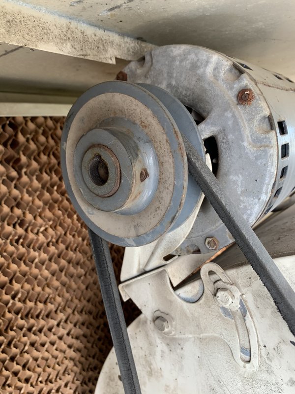

^^^ so after all that...filled the pan with water , ran the pump to soak the pad , and then turned on the blower. Need to adjust the spray bar. Which presented more issues....

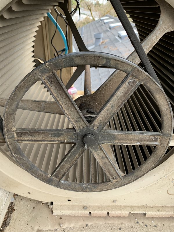

Just gonna order a new belt from some other outfit. Last one said out of stock unknown when back in. I’ll match it up with the local auto parts know it all’s...
Adjustable pulley on motor end looks fine and Allen is tight
After running it longer than last time...I heard a slight banging. Guess what !?!?
The last service company...ruined the blower pulley...by not getting the key in all of the way and set correct pressure on the Allen screw (wasn’t on it at all). Only the jetway was sitting in the pulley this entire time. It wore the outside grove to cause enough play to be annoying...back to ordering more parts. I am never this annoyed and I’m not sure it’s worth it , but I actually found the receipt to the last service company that did the work from previous owner. SMH
More parts to order tonight that should have never been an issue. People are shifty...

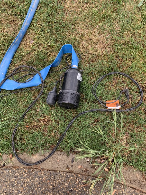

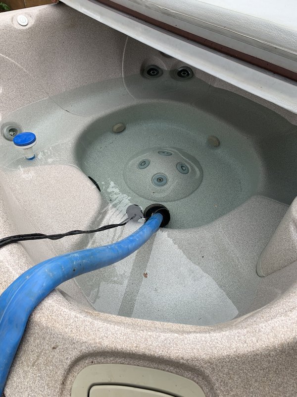

Got lazy and used a sump pump to drain and wipe down the spa. The drain valve that should have been there by manufacturer design or schematic was not... didn’t want to screw around or play “let’s take off all the panels to see if I can find that drain valve....to make my life easier”. Maybe there was or wasn’t. Blue don’t care. Watered my lawn with 300-400 gallons in a matter of minutes. The ground has been so dry it took it up rather quickly...
