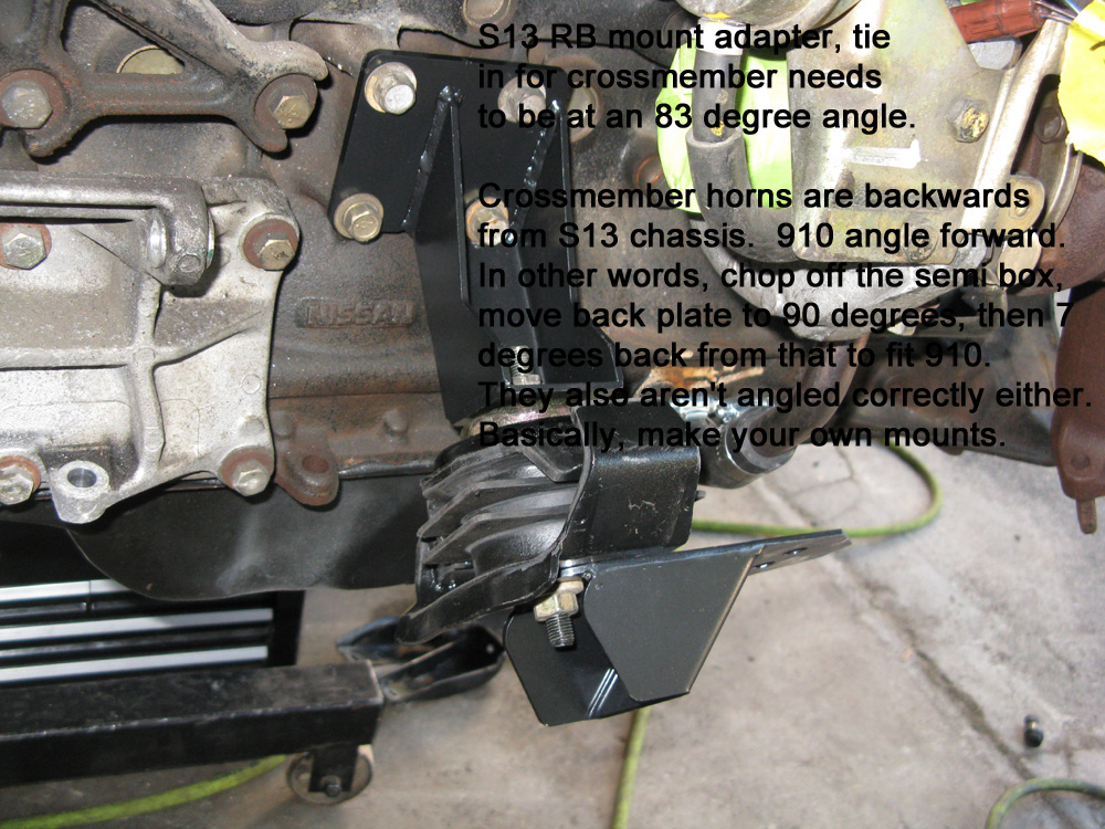

Ok, so not that much progress has been made, but I can tell you, don't buy the Black Path S13 to RB20 conversion mount set. The engine brackets are decently constructed, but the adapters to the crossmember are supremely thin. Not to mention, the amount of adaption is stupid. In other words, I wasted my money and destroyed the mount set so I couldn't return it.
Because Datsun.
Anyway, I have some very thick plate I'm going to use instead, but I also have an idea to use the 240sx mounts only and move the block mounts back on the bottom edge. Driver's side (ours) has no problem with that, but the passenger side oil filter location is in the way pretty decently. However, I'm thinking the oil filter boss between the RB and KA24E out of the pickup is the same. The D21 version is angled. Thus, change the mounting boss and gain clearance. I don't know if I have another oil filter boss kicking around. Hoping I do so I can confirm. If I can't do that easily, I'll continue replicating the mount set I got, just changing a few things.
The other issue is due to using 240sx mounts,I'll have to grind or space them up so the edge doesn't hit the crossmember horn, which isn't a big deal really. Also, since I was following the other old ratsun 910 RB thread, I'm pretty sure I didn't need to clearance the pan. It looks like it would have cleared just fine. Oh well. And it may be a combination of using the 240sx mounts, which are probably a bit taller than the RB mounts (one was ripped, why I didn't use those)
Oh, also, the turbo downpipe goes right into the steering shaft. My solution to that is to buy a new downpipe and section it longer so the flange end is below the steering shaft. Then some custom lines for the power steering pump, then some custom figuring for the AC compressor. Either way, it's getting closer!
And here are some pictures!

Alright!!! Got the nice and thick 3/16 plate engine mount adapters done! Need to put them on the crossmember and drill the front hole for the additional tie-in, but other than that, I'm almost ready to secure the engine in the car. I'm actually tempted to put the transmission on as well and put the whole assembly in, though I don't have the crossmember even close to figured for that. Either way, I'll have some time on Friday and Saturday to figure out how I want to do that. I'm thinking I'm still going to put the engine in and the transmission in later from the bottom, but we'll see.
