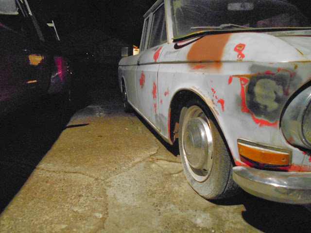

Posted: Mon Jan 13, 2014 10:56 pm
This is what I did today, I originally planned on doing it the way Jrock did it, putting a tube in the frame, but the 720 frame is offset, so I used the roadster setup to flip the rear leaf mount position.
The photo below is with the rear tires still off the ground.
It was to dark to take a photo of the stance, so I will do that tomorrow, I think I dropped the back at the bumper about 3 to 4 inches.

OK, I just did some measuring.
The leaf originally connected to the shackle 5 inches below the frame, now it is connected 1 1/2 inches below the frame, a 3 1/2 inch drop at the rear bumper, likely closer to a 3 inch drop at the top of the fender well.
I would be resting on the frame right now if I had not notched it.

Posted: Tue Jan 14, 2014 6:28 am
Man, you're gonna need a full length skid plate just to get in and out of the driveway.
Re: Waynos 1966 datsun 520 ute
Posted: Tue Jan 14, 2014 9:54 am
DRIVEN wrote:Man, you're gonna need a full length skid plate just to get in and out of the driveway.
No, I don't drag in my driveway, I used to, I actually hardly drag or hit anything except speed bumps like the small type they have in apartment complexes, them are an issue, but the big ones on the city streets are not an issue at all.
I will admit that if I hit the driveway to fast, where the tension rods used to connect in the front does hit, I still have to cut them mounts off, but I always leave stuff like that alone for a while after making a big change like that, in case I have to change back because of some issue I did not see coming.
There is one more thing I could do in the back to get down another 2 inches, but I will have to mod the lower shock mount, not sure it's worth it yet, need to take the truck out of the driveway into the street to look at the stance, it's hard to tell how it is sitting in my tilted driveway, I will get some photos.
