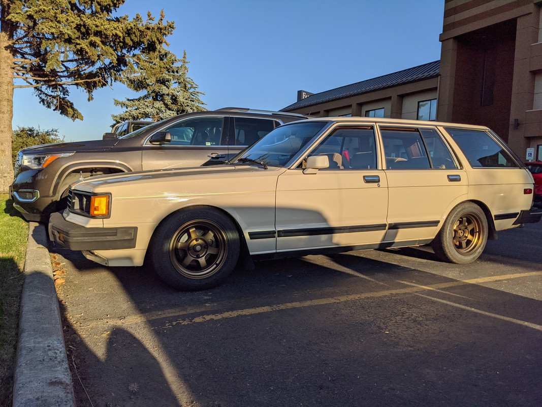

Anyway, point being I got to cruise the wagon last night, and it was glorious! Actually went to a small car meet. I know, social distancing. I had planned on staying away, but it was definitely fun and the wagon was a big hit. Even better, a local cop came by and was all stoked by it!
I even raced Andy Kazanis in his Datsun roadster from the light. I need an LSD. Peeled one tire all the way through 1st, and yes, it's still quick!
Here's a few pictures from last night. I totally forgot to get one of the wagon, lol. Didn't take that many anyway, lots of other vehicles. The Impala is Ray's, he used to be the forklift driver for Spaldings back when I worked there. Had a sweet 720 bozo truck, and some nice Skylines, one with a turbo as big as my head!

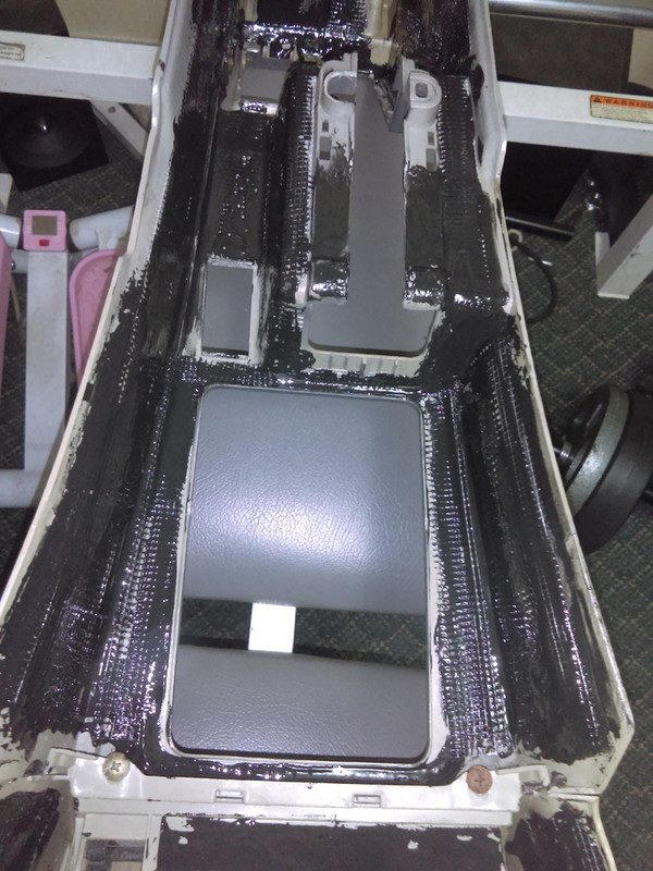

A little console action tonight. Got the radiator flushed again today (brown rust water, bleh), re-did the rear driveshaft flange and re-seated the u joint. Much nicer now. Put the new factory blow off valve on. And here's some center console preparation. Drywall mesh tape stuck on first, then coated with 08115 3m panel bonding adhesive. Should make a pretty bulletproof console. Then have to paint. I'll let you guys know how it turns out. Free kitty returned from 1-2 year hiatus with probably worse cancer in her eye, but kitteh don't care! Nice to have her back, I started feeding her again.
EDIT: 8115 takes FOREVER TO CURE! Full 24 hours, and longer if below 73 degrees. However, there is an on demand heat cure with this product. My body man said be careful of too much heat, it might peel. Took the regular hair blow dryer to it just now, that seems to have done the trick. I'll let it cure more for today before I go about painting it, but after 9 hours curing this morning, it was still super wet until I hit it with heat.
ALSO, note the block of wood with holes and two different dowel lengths. This cartridge requires the special applicator gun. Or, if you don't want to spend 50 bucks on a special gun, make an adapter block for a regular caulking gun. My old NAPA parts guy told me that. Worked like a charm! The two different dowels are because you have to use the short dowels initially to get more space to insert said dowels, then longer ones to get all the product you want out.
