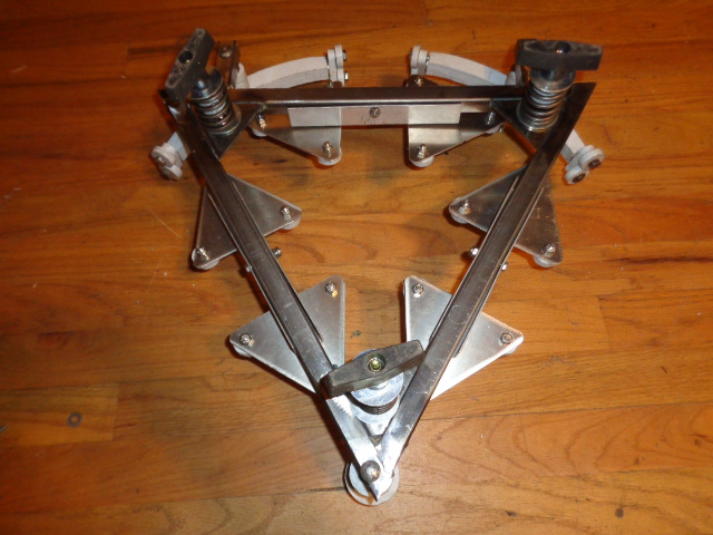

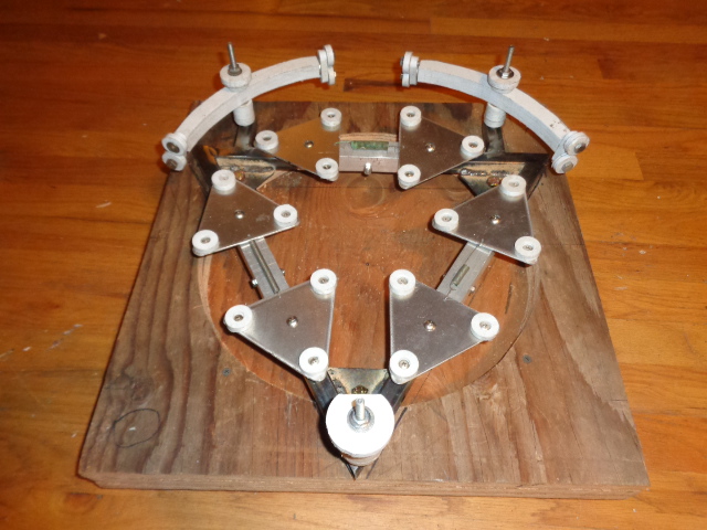

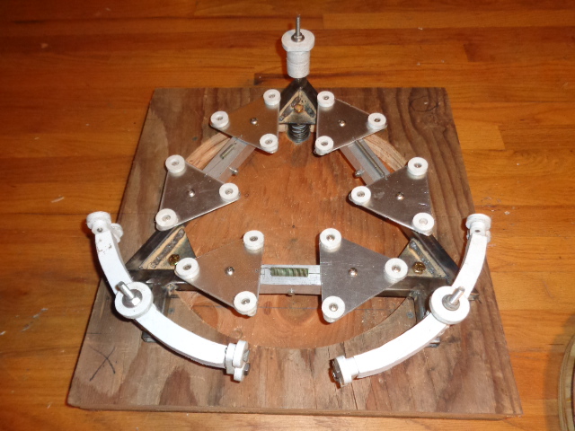

Well I made the real mirror cell and new plastic arms, I like the wood ones better.
It's a lot nicer now, everything works as it should so far.
I think I am going to dump the plywood box and make a metal cage, but that will make the truss poles harder to deal with, need to think about it.

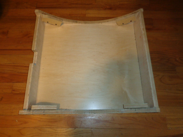

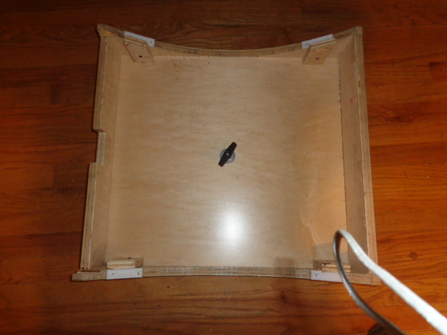

This is where I am now, the mirror box it too small now, but I was not going to use this one anyway, I am mocking stuff up to see what will work.
I planned on holding the truss tubes in with this under what I used, but this was the only one that did not fall apart, cheap plywood.
The mirror does actually fit in there, but it needs to be a slightly bigger box.

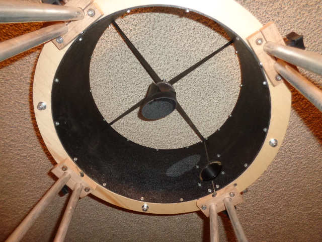

#963

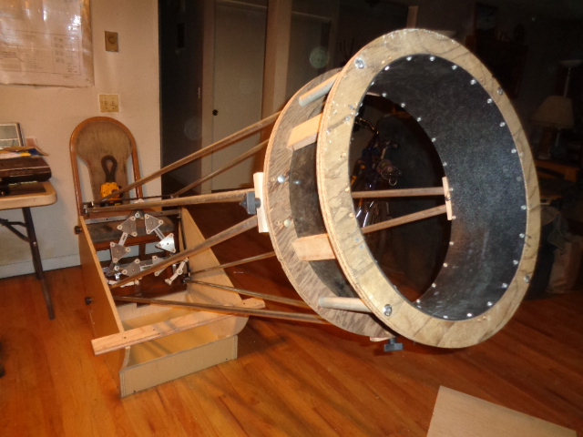

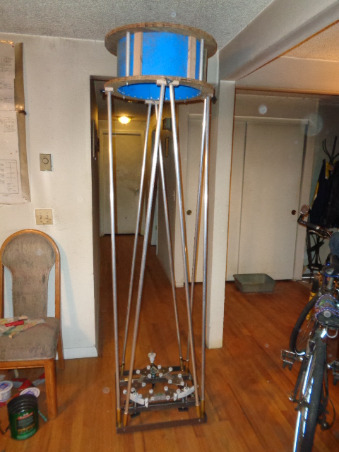

Here is what it looks like now.
I have not cut the tubes yet, I need some other stuff like a secondary mirror holder/mirror, I need to make spiders but need the secondary to do that, I measured stuff out and sitting on the ground like it is in the photo the focus mechanism would be eye height, and that is without the mount, so I need to make something low profile.

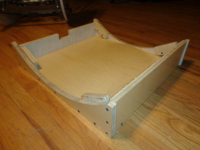

#964

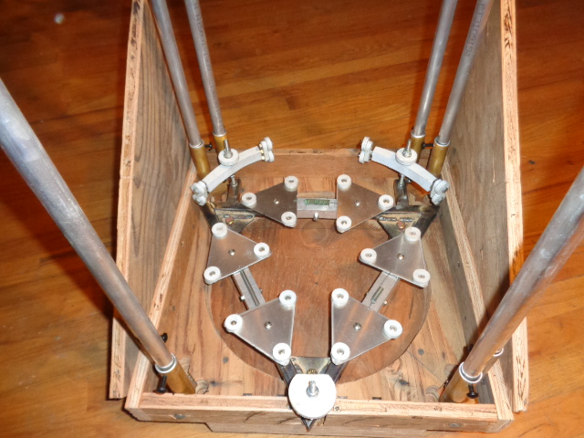

I have decided to do away with the wood mirror box, it weighed a lot and the plywood was falling apart, even though I could buy way better plywood I decided to make a mirror cell holder out of metal, so far it is way better and I made it larger, it was 18.5" square, now it is around 20.5" square and it weighs less, everything you see in the photo below weighs only 35 pounds.

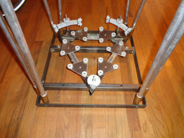

Here is the new mirror cell holder.
Here is a broken truss tube mount bracket, I am going to try another design tomorrow that should make it way easier to put together, it should make it easier to put together is the part I am not totally sure about yet, it could make it harder to put together another way.

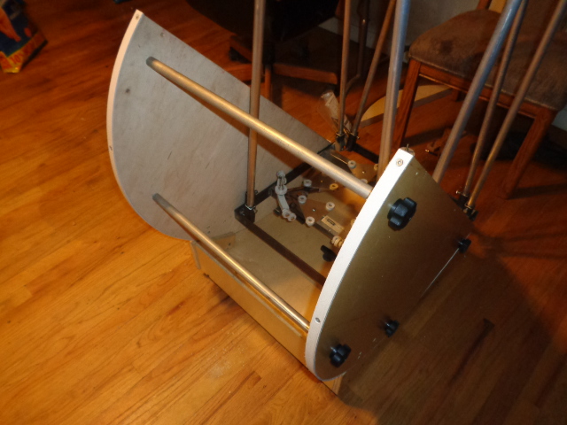

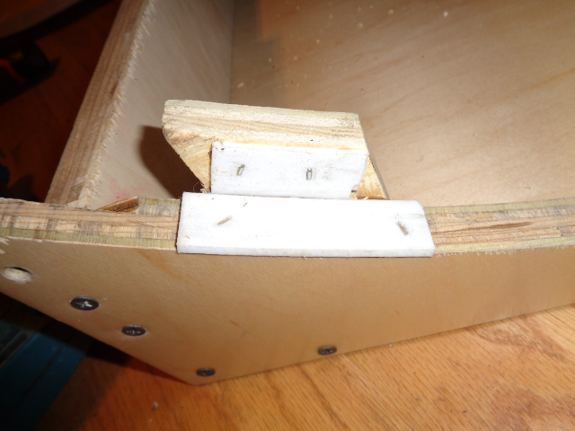

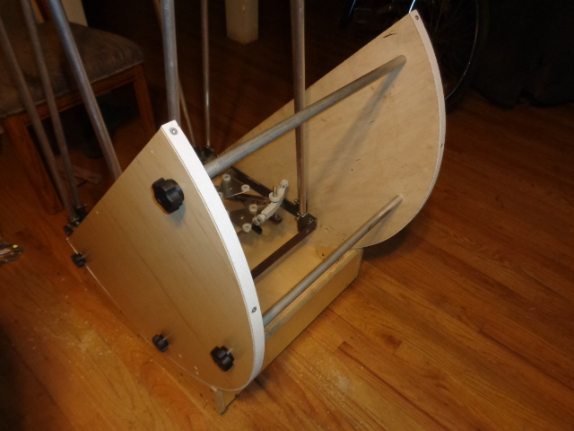

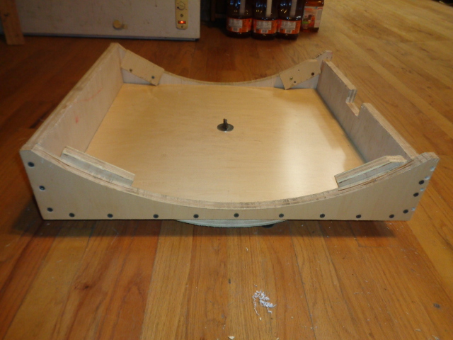

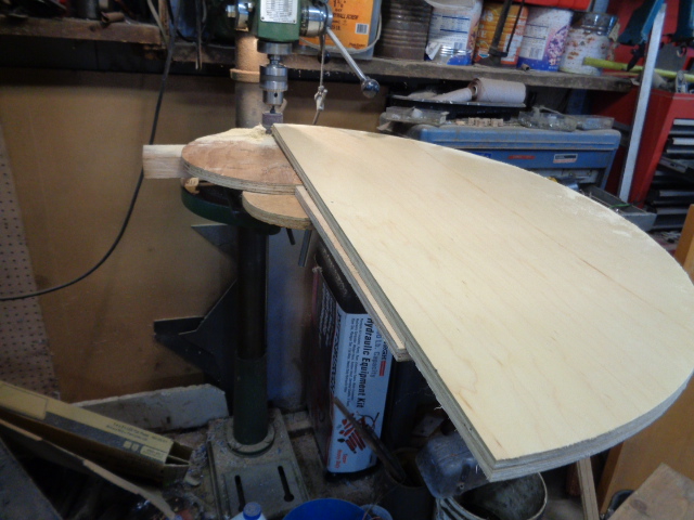

Well it is looking more and more like a telescope everyday, I made the side bearings using my drill press and a jig so I could rotate the piece of plywood and make a perfect half circle.
Then I made a base to set the telescope assembly in.
Here it is before I made the turn table out of the base.
And here is the base with the bearing installed that allows me to turn it 360 degrees.
I made another smaller upper tube assembly(UTA), it is lighter and made of black plastic instead of blue plastic.

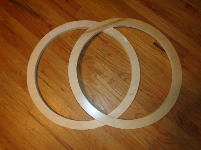

And here are the new UTA rings I will use to make my good UTA.
As I said before I am mocking this stuff up to see if it will work, once I get it done I will need to take it all apart and stain it to make it waterproof, but I will only do that as long as I am not going to be drilling any new holes, so everything has to be mounted/put together as it will be when in use, I also need to paint all the metal parts black or cover them with black, I will be looking for heat shrink for the truss poles but before I do all that I need to find a secondary housing/mirror and make the spiders to hold it so I know what length the truss poles need to be.

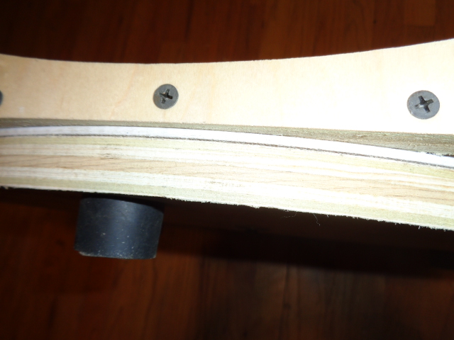

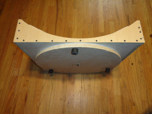

I made some progress since last time I posted, the Teflon came today so I put that on the scope and now it turns and raises ans lowers much easier.

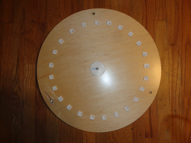

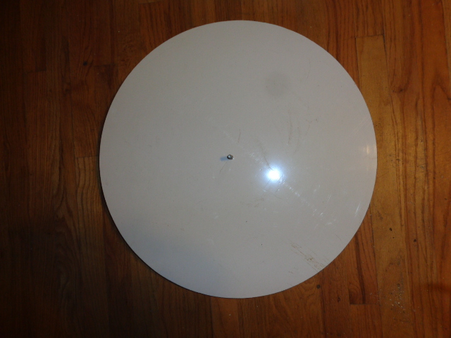

Then I did the base, there are 24 3/4" squares of Teflon held on with my air staple gun like what was used to hold the side bearing pieces in place, I also put a center piece in.
Then the plastic circle with the textured side down resting on the Teflon.
Then the base on top of the plastic circle, I did not staple the circle to the bottom of the base as I do not think it needs it as it has enough friction to stay glued to the bottom of the base box, whenever I turn the scope the plastic rides on the Teflon.

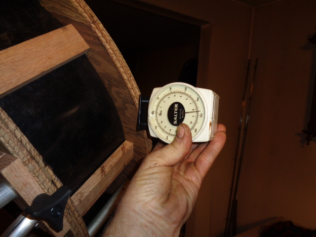

It only takes 10 ounces to get it turning and it takes 10 ounces to keep it turning, so it is not sticking which is what you do not want it to do as if it sticks when you try to move the scope and it gives all at once you lose what you are trying to look at, you want it to move smoothly and not stick.

I have been told that them 24 squares I used in the base will not work, it was suggested I take out all but 3 of them over the legs, but that is one of the things I have done that has worked flawlessly so far on the first try.
That Teflon is only a 1/16" and 1/8" thick, it is more flexible and softer than plastic, but feels like plastic and it is heavy for its size, it also is kinda expensive, but ebay has lots of sellers so it can be found for a reasonable price in smaller pieces like the 12" X 12" sheets I ordered if you consider $20. to $30. cheap.
What is really strange to me is that white plastic ring/disc I used has a textured side and a smooth side, the Teflon sticks to the smooth side and slides easily on the textured side when I rub a piece of Teflon on it, same with Formica, Teflon slips better on textured Formica than it does on smooth Formica, I was going to try the plastic to see if it would work and it did, Formica cannot be bought in large sheets at HD or Lowes as i asked while I was there picking up the Maple plywood, I have more money into plastic knobs and SS threaded screws/nuts than I do into anything else except the primary mirror.

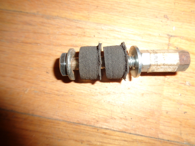

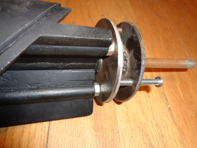

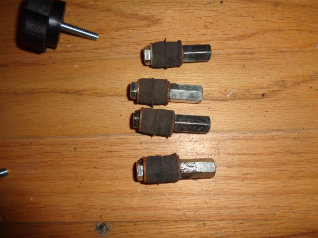

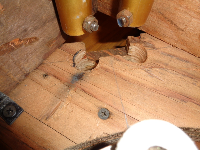

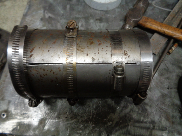

I also added some side bearing bracing a couple days ago, I made my own compression fittings to hold the coupler nut in place in the tubes.
Here the braces are installed onto the side bearings.

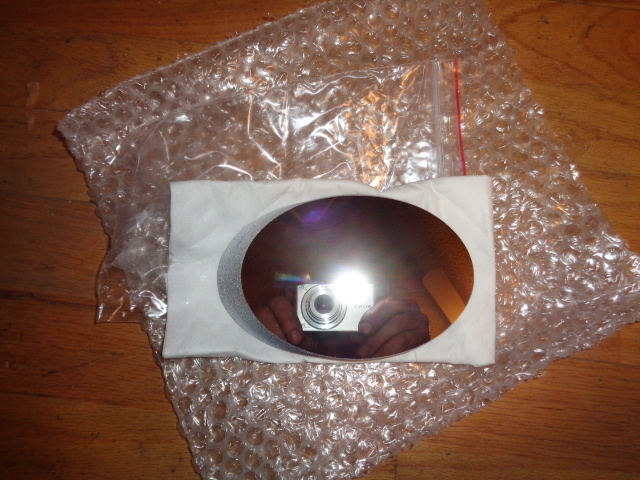

I received one of the 2 secondary mirrors I am buying for this telescope I am building, it is huge, it is 3.5" across the short/narrow side, it would be used for looking at DSOs(Deep Sky Objects), a smaller one is coming that would be good for planet observation.

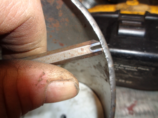

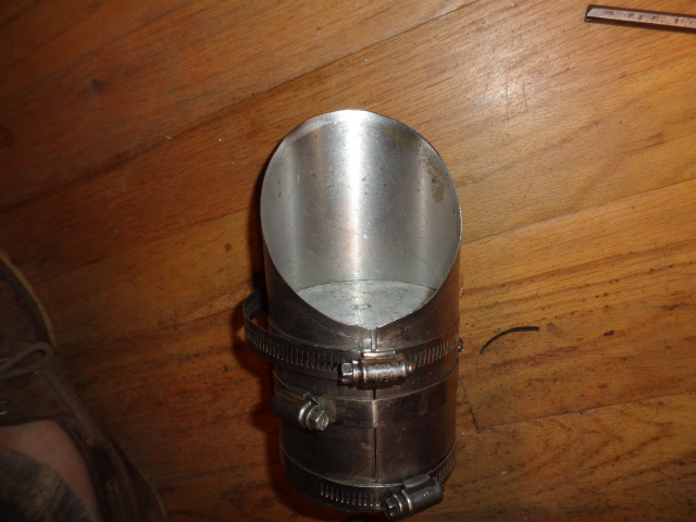

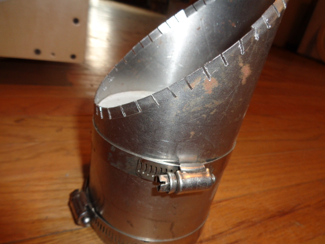

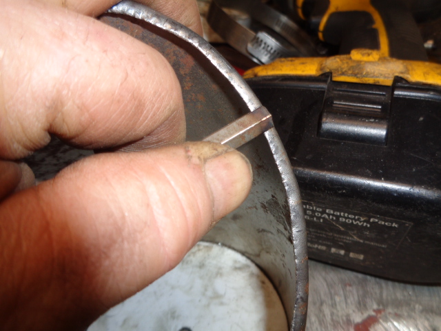

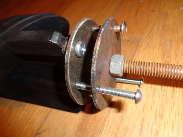

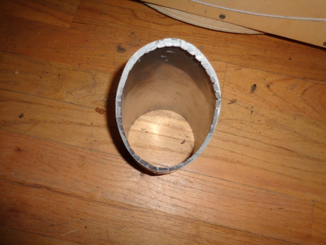

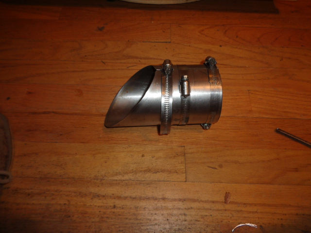

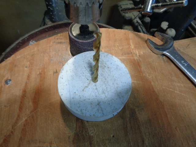

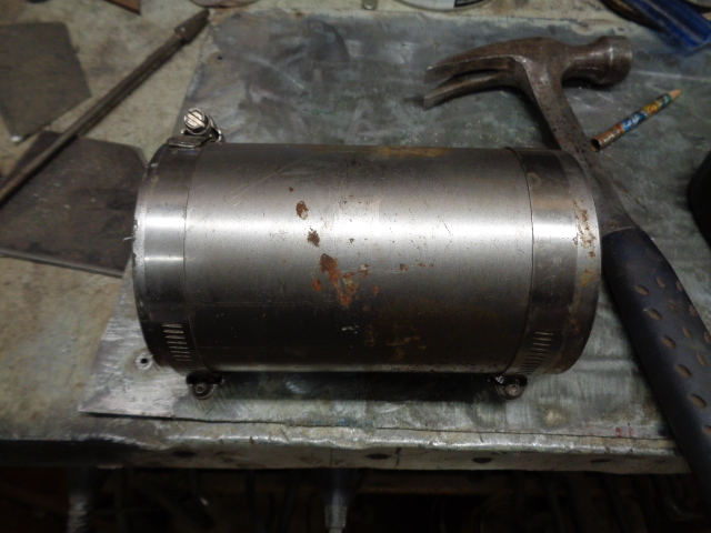

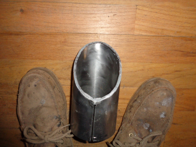

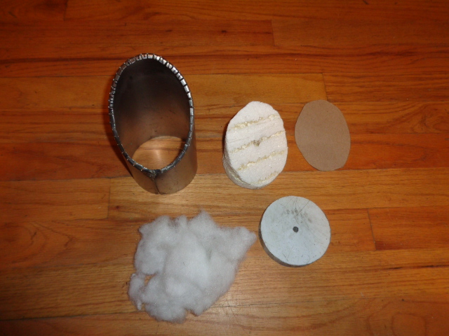

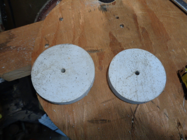

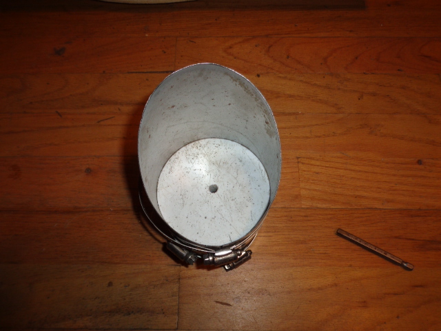

Well I started making a holder for the secondary mirror today, the first one was a failure but I learned a lot and the second one looks a lot better, it is not done yet as I am waiting to see if anyone on the telescope forum has a better way to make a lip to hold the secondary mirror in the holder.

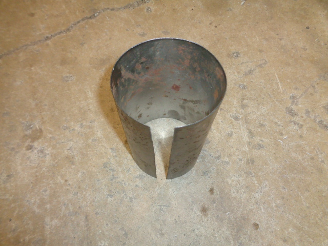

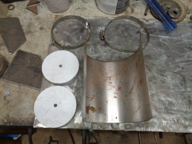

I made the base piece and another one so I could make the secondary round out of flat metal, I used a 4" hole saw to make the plastic base and another one to help me keep it round and then I used a jig I made to make them perfectly round the size I needed, I actually made 3 as I messed one up.
Then I had to cut it at a 45 degree angle as that is the angle of the secondary mirror in a dob telescope.
Then I made a little tool to make a lip all the way around to hold the secondary mirror in.

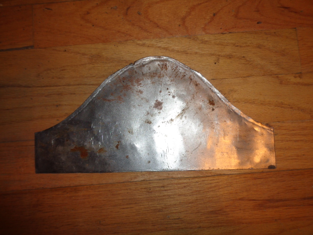

It really did not bend like I thought it would, and I went slow.
This is what a tube looks like when cut at a 45 degree angle and then flattened out, my first try did not work.
When I did not like the first try I made another one using that flattened piece as a template.
So this is where I am at right now, I am waiting on the lip to see if anyone has a better way than the way I thought of, I don't really have the materials to make a metal secondary I can stick in the holder and then use a hammer to make the lip which I am sure would be cleaner looking.

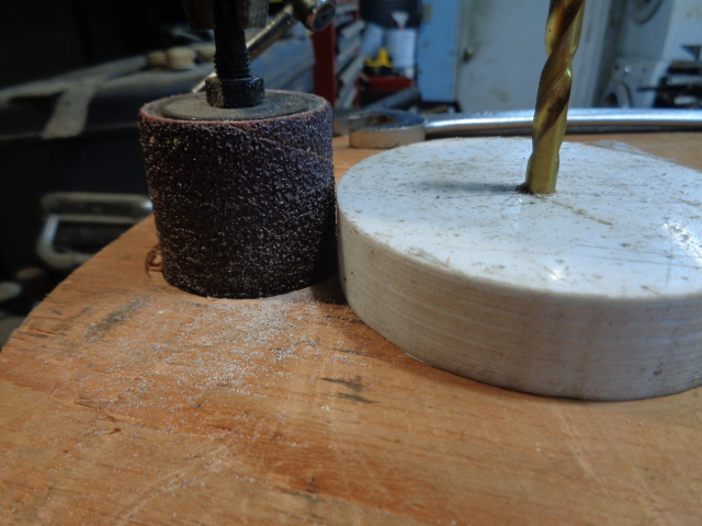

It took me all day to get this to where I was happy, it is hard to make something like this from scratch without the proper tools.
I am now waiting on a spider assembly that is on its way, I believe it is the right size, spiders hold the secondary that I made today in the Upper Tube Assembly(UTA).

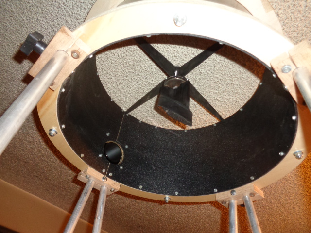

I modified the smaller secondary to fit my scope, but I will have to go back to the larger UTA(upper tube assembly) as the spiders I bought will not work with the smaller UTA.
This secondary assembly was not made for this type of connection so I made what I needed.
It started snowing today so I might build the larger UTA tomorrow with the new rings I made a while back.

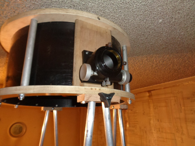

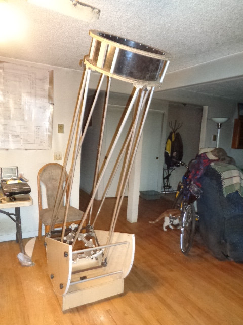

I actually put some bondohair on that secondary holder and then sanded it down, it needs one more coat to make it look really good when I paint flat black so there will be no reflections from anything but the mirror.

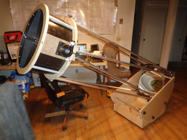

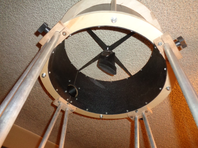

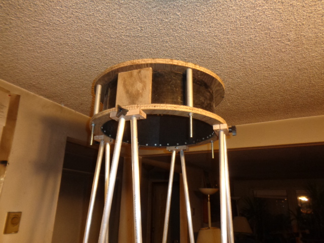

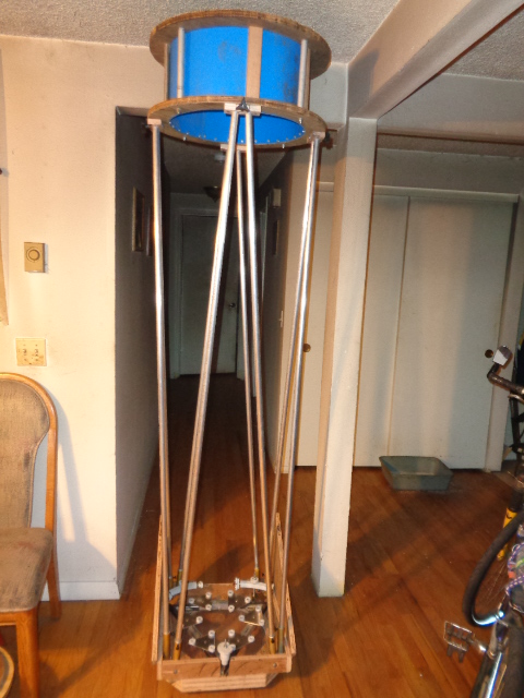

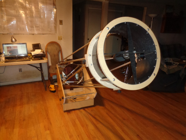

I put the upper tube assembly together today, everything I need to do is done except for the cutting of the truss tubes to make it the correct focal length, right now the measurement is 2137mm, but the primary mirror has rated focal length of 1811.15, so I believe I need to cut off 326mm(12 13/16") off each one of the truss tubes as if you minus 326 from 2137 you get 1811, this will put the upper tube assembly/secondary mirror at the proper height for it to come into focus within the range of the focuser assembly and eyepiece, I racked the focuser in and out and called the measurement in the middle/center what I would use, but I am waiting for the folks on the telescope forum to confirm what I came up with, I published all my measurements in my build thread there.
Here is what it looks like as of tonight.
It needed some weight in the rear because the truss tubes are too long and putting the weight of the UTA out there too far, once I cut the tubes I am hoping that it will not need the 8 pounds of weight in the photo below, that is scrap metal and a pair of vice grips.
Once I have everything done and I test it to make sure it is working properly I will need to tear it all apart again and seal/stain/paint all the wood and metal parts, I have not even looked for shrink wrap for the truss tubes yet, I need eight 5' pieces or a 40' piece.
