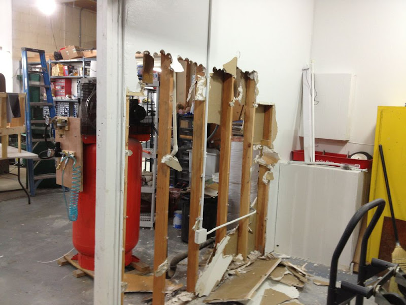

After being in the space a while working on other parts of the shop I decided the hall way was of little real use. So, I did this.
Cool side-by-side before and after:
Joists tied the existing wall into place.
(the electric heater is no longer in use)
The ceiling joists are 2x8 with reused 3/4 plywood for the deck. I plan to store some stuff up there. The height to ceiling is only 54" so no standing.
