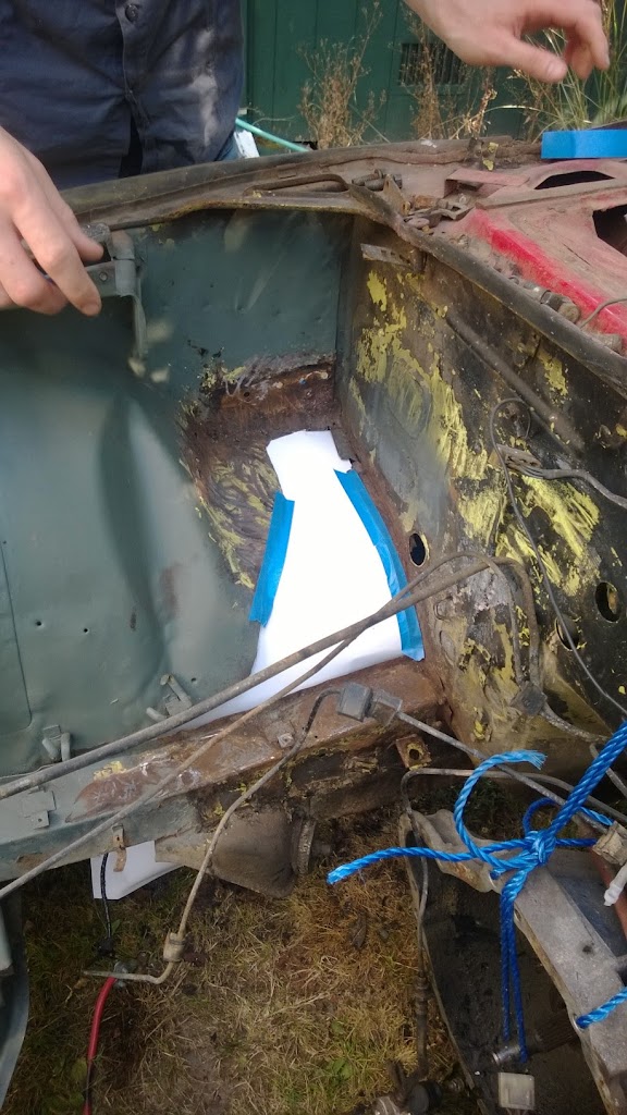

Other than that ive been burning off old bondo and removing fibreglass patches, hammering out dents, removing rust, and re-aplying bondo (tho significantly less than PO #1 did) and gathering parts, I now have a passenger floor pan ready to weld in =)
