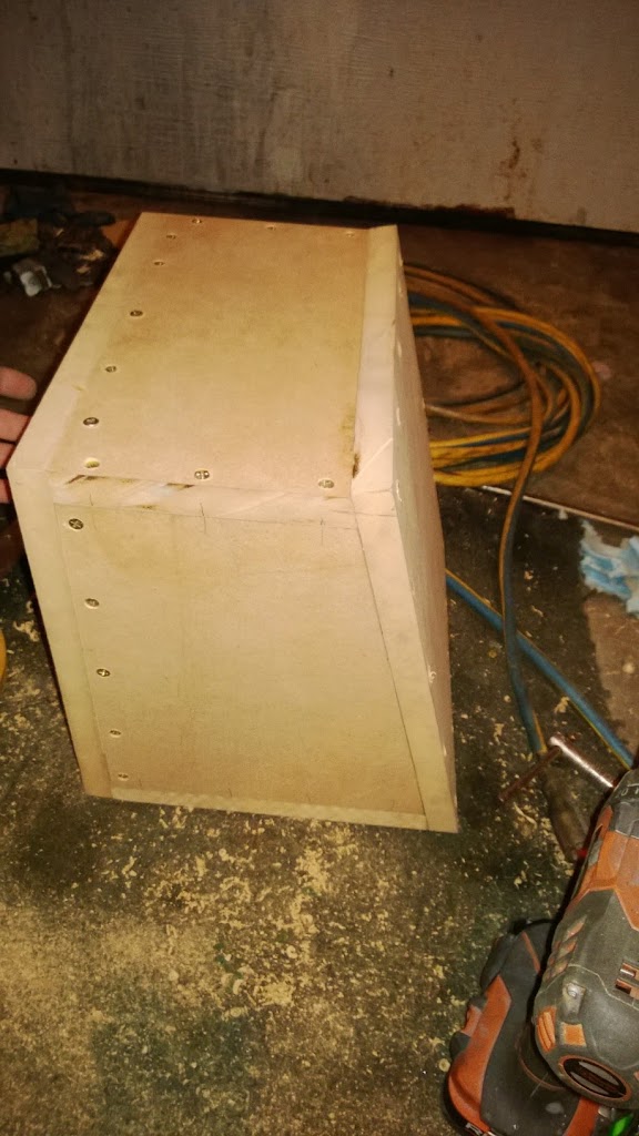

8" Infinity. 250w RMS, 1000w peak, 4 ohm (my amp does 200w RMS at 4 ohm/350w RMS at 2 ohm)
Re: My First Subwoofer Box
Posted: Tue Aug 20, 2013 12:38 pm
So how much did this box cost to build?
$12 at Home Depot for 2x4x3/4" MDF
$6 for a box of screws (well I still have a decent amount left over so that will roll into another project) at Home Depot

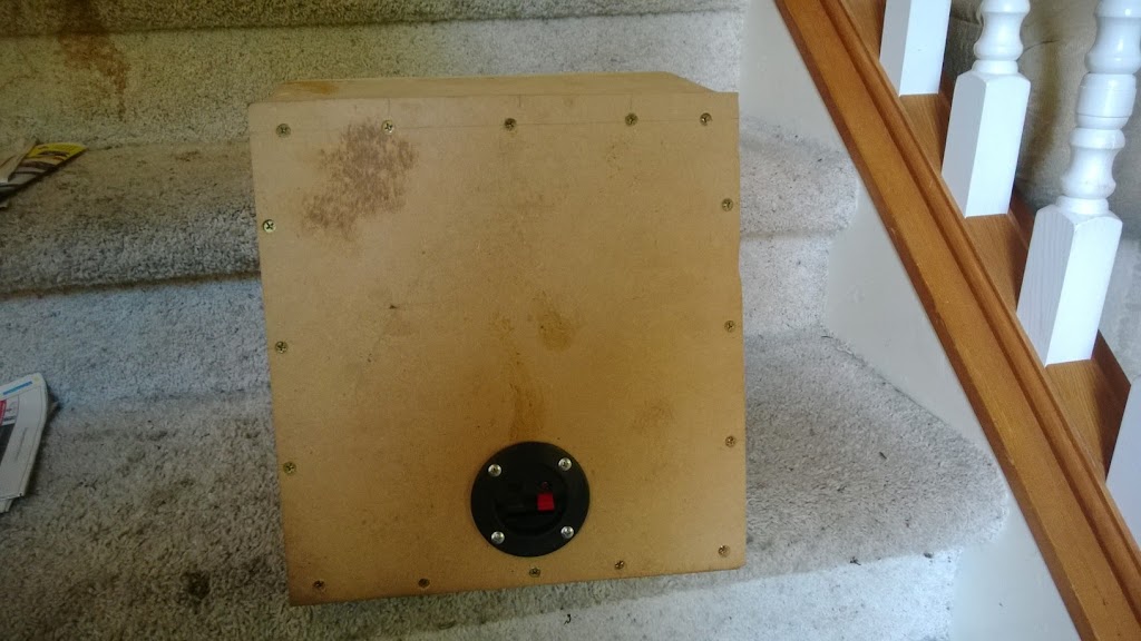

$4 for a terminal box from Amazon (I ordered it with my Sub, and Amp install kit)
I already had wood glue...
Tools used
Table Saw (stupid Ryobi POS)
Cordless drill. I never even had to change out my battery building the box!

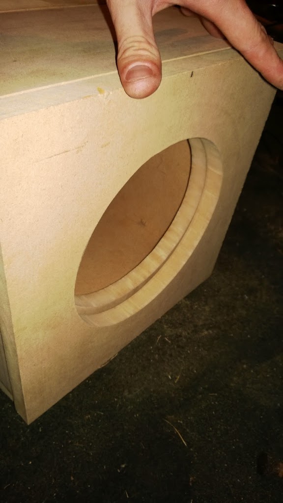

Jigsaw (I have a 12v Craftsman cordless one. Its pretty cool. Battery charge made 1.75 circles for the hole of the Sub)
Clamps
Hacksaw (Ok I just used my cordless sawzall, it was there...)
The box ended up being pretty heavy. And then with the weight of the Sub, it got really heavy. I would in the 25-30lb range.

I used to build these for a living. Use caulking with the wood glue, it makes it air tight. And depending on the speaker wattage and size (diameter) It may do a little better in a bigger box. There's ways to calculate.
Posted: Tue Aug 20, 2013 4:52 pm
I did calculate. And thats what it wants for a sealed box. Its just an 8 inch sub.
And now its hooked up. It definitely hits pretty dang good.
