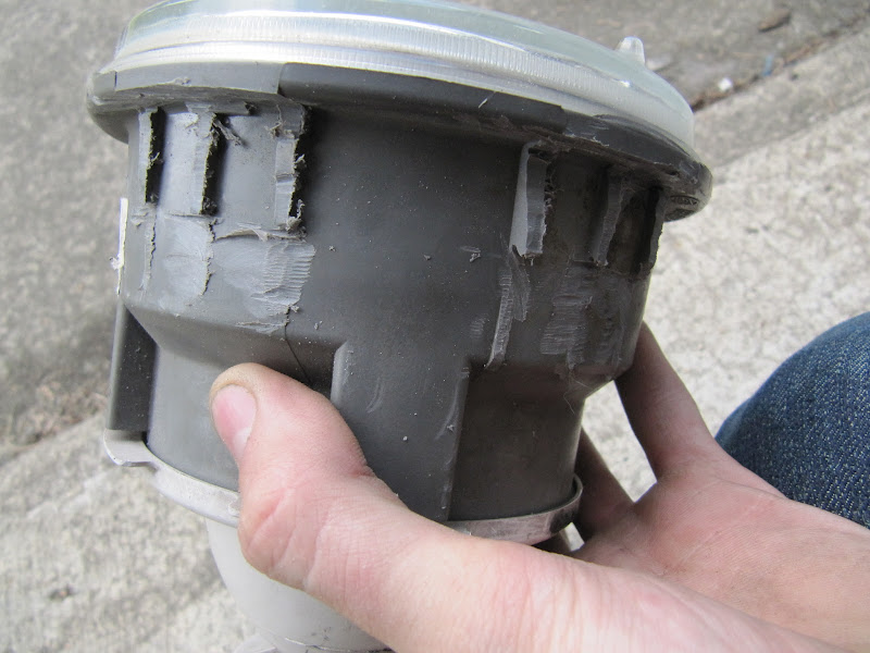

Take out all your headlights/brackets. Remove the cups for the low beams. I then cut 1 inch from the front of the front the cups to make them look like this:
Next step is to remove the Chrome rings from the ellipsoids. Then to shave down the tabs to the following, This is where the dremel was most useful.Bit of trial and error in this, make sure to shave all the way through.
Then slide the cup onto the ellipsoid and screw the retainer ring done.

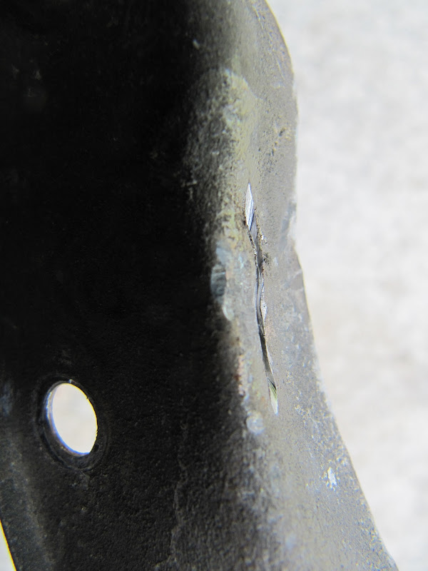

Next we need to modify the bracket that holds the lights. Angle grinder to the rescue! From this:
to this:
I ran into a clearance issue with one of the bumps on the bracket obstructing the ellipsoid, this is the bump:
I then cut a slot in the bump and hammered it smooth:
