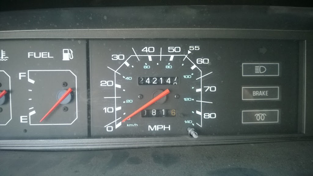

Since NOTHING works. I think its a fusible link. I mean, no power to the interior fusepanel which controls 90% of the car. Its gonna be a simple fix. And since Derek moved closer to me (same town now), things will happen.
No lights work, none, including brakes.
Dash does not work, no lights, indicators, speedometer.
Im guessing the Glow plugs dont work because of said issues (why it wont cold start on its own)
Engine runs perfectly, idles smooth. A bit rich though, as there is mass amounts of black smoke on acceleration (rollin coal!)
Rear doors dont open, I think they are stuck locked...
