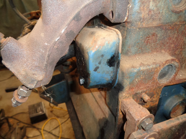

This is the block breather/assembly on a spare engine in the garage.

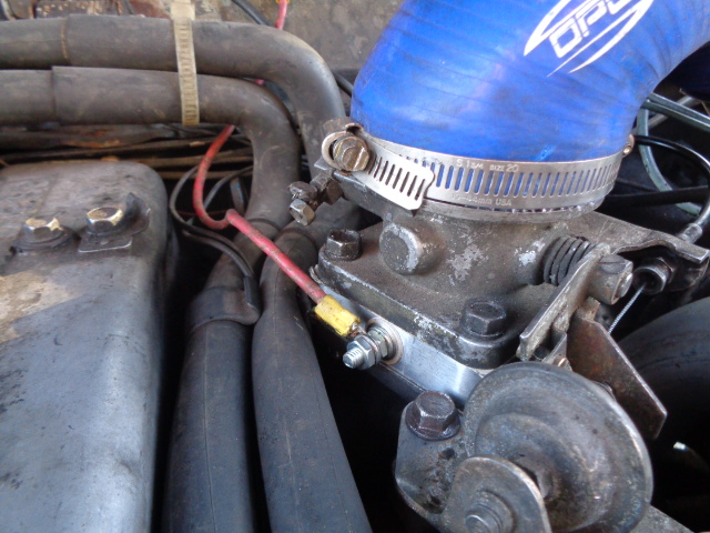

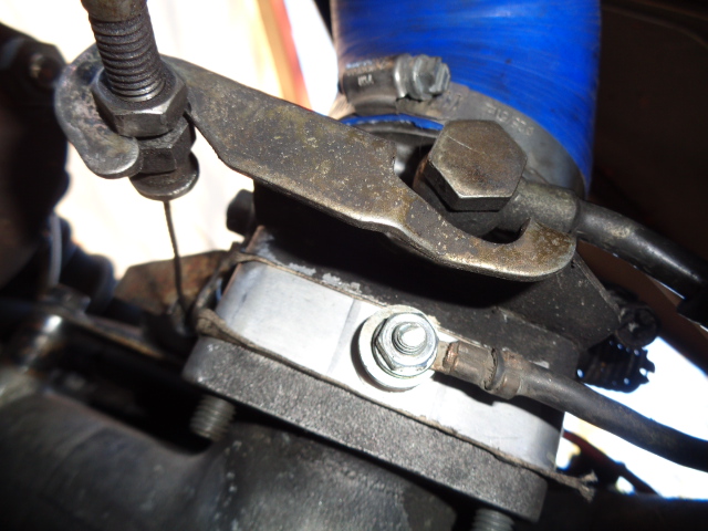

Here is the Air Heater Element installed under the throttle body, the red wire is ground, the black wire is 12V, it just turned out that way wire length wise, I didn't have a red wire the right length/gauge.

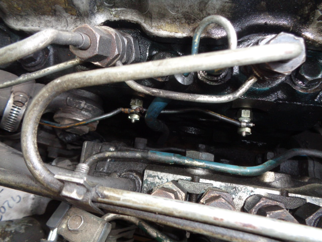

I put the glow plugs in today, kinda hot out to be doing this type of stuff(97 degrees), but I have a hard time getting to sleep when it is above 70 degrees, so I wake up late and get a late start doing things.
I don't know how they work yet other than it took a little more cranking before it started, but it was a lot smoother after it started, if it continues to crank that long next time I will remove the oil pressure switch wire and see if it starts right up, if it does then it is that switch, this system requires oil pressure before it will allow the engine to start.

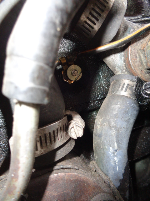

Here is #3 glow plug, it is the hardest to get to, I had to use a mirror to be able to see it to put the wire on it and tighten it down, I could not see what I was taking a photo of as I could barely get the camera in there to get this photo.
And here is #1 and #2 glow plugs, the only reason they are not the hardest is because I can see them, if I were to remove the injection lines I could get to them easier, but then it would be much harder to get started and I don't like turning it over a long time anymore, it is hard on starters.
