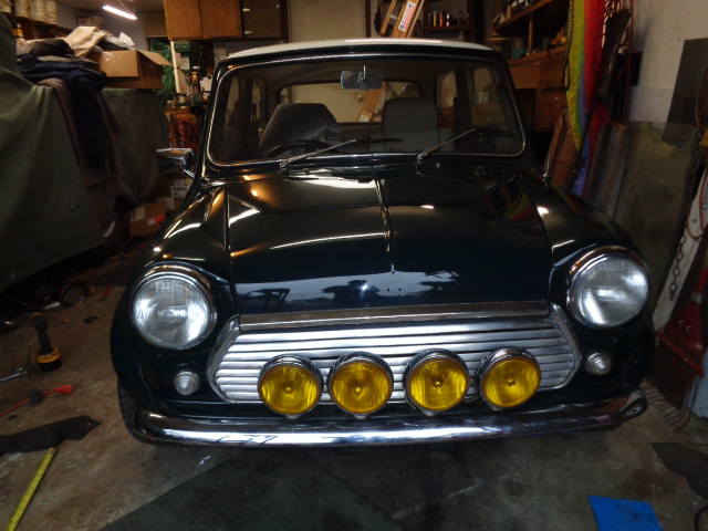

I spent way over an hour trying to find one of these badges for sale, I had already checked ebay and could not find one but it turned out I didn't word it properly, I finally found one at Moss Motors and wording it properly on the ebay search found me one there, still there was only one in 10 pages of the ebay results as that is where I stopped, normally I would not make it past the 3rd page but I was on a mission by then.
I pulled the louvered hood I had out of the box as I replaced with a stock hood(that's how I got the box), it had the badge on it but it was glued on and it wasn't that pretty, I figured I would break it trying to get it off and that is what led to my search for a new one.
I finally found an oil filter(WIX) but it was not the one I went after(WL7142) as they didn't have that number on the shelf, so we looked up the Chrysler Omni, he then had the thread slope and the gasket size across by that, went to his book and found one for me, they had a generic for half the price but it was made in China, but I went for the WIX hoping it is not made in China also, I didn't look.
I bought anti-freeze and filled the radiator up and started it up and ran it for a while(warmed it up), pulled it down off the ramps and so far no oil leaks, there was a coolant leak, at first I thought it was the thermostat cover so I tightened down the bolts but they were already snug, I used air ti dry it out in that area and finally figured out it was the upper radiator hose connection to that cover, I had to tighten that clamp up really tight and it was still leaking, so then I went even tighter and it finally stopped, I think that is the tightest I have ever got a hose clamp without ruining it.
I tacked the exhaust pipe to the header so it will not move/fall off, I also had to tighten the 2 center nuts holding the exhaust onto the head as I could see a puff of exhaust smoke shooting straight up between the valve cover and the carb, I didn't see any more smoke, they are very tight now, I was a little worried I would start pulling the studs out of the aluminum head, I went really tight.
It's ready to drive now, but it is raining outside, I don't drive this when it is wet outside.

It looks really, really good. That emblem will be a nice finisher.

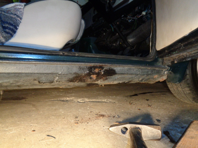

Well I guess I have more work to do on this Mini now, I kept feeling moisture on the driver side floor, so this evening I lifted the rug, and several layers of matting and it was wet underneath, so I removed it all and found major rust, it also looks like some moron was jacking the car up using the floor board sheet metal instead of the sub-frame, the left passenger side I was able to just use a sledge and pound it more or less flat and only found one little spot with a rust hole, otherwise it is solid, likely an easy fix.
The driver side(RHD) was another story, I have been looking at the rocker area for a while now and found a place that I believe I can buy that, while looking for that part I found a RH front floor pan also, so I went out there and was looking at the inner rocker to see what shape it was in, it appears to be fine and that is when I felt the moisture again, that is when I started tearing things apart.
Here is the rocker area, the larger hole is supposed to be there but that is a patch panel, so the inside guts are not there to support jacking the car up, the hole above it is not supposed to be there.
I knew about the rocker(other side is fine), but I didn't know about the driver side floor board, and I have never drove this car in the rain so it was there before I bought it, the water got in this time because I pressure washed the engine compartment, and there are a few holes in the firewall on that side, I am drying it out with my work light, I will call about the replacement parts tomorrow.
There was a lot of layers of matting in this little car, 3 different layers and then the green rug, plus it has that stick on tar crap from the factory that started breaking off when I flattened the passenger side leaving good looking metal below it, I suppose it was there for sound deadening, maybe it would have been better to put a better muffler on it, but maybe the muffler was put on it to hide the road noise.
