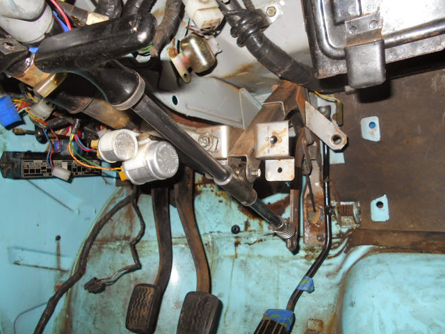

Since it is going on a disc brake frame, I also made a power brake setup.
The pedestal and clutch master in position, I did it a little different this time, I kept the clutch master separate from the brake master pedestal.
The passenger side.
The steering column shaft down there.
