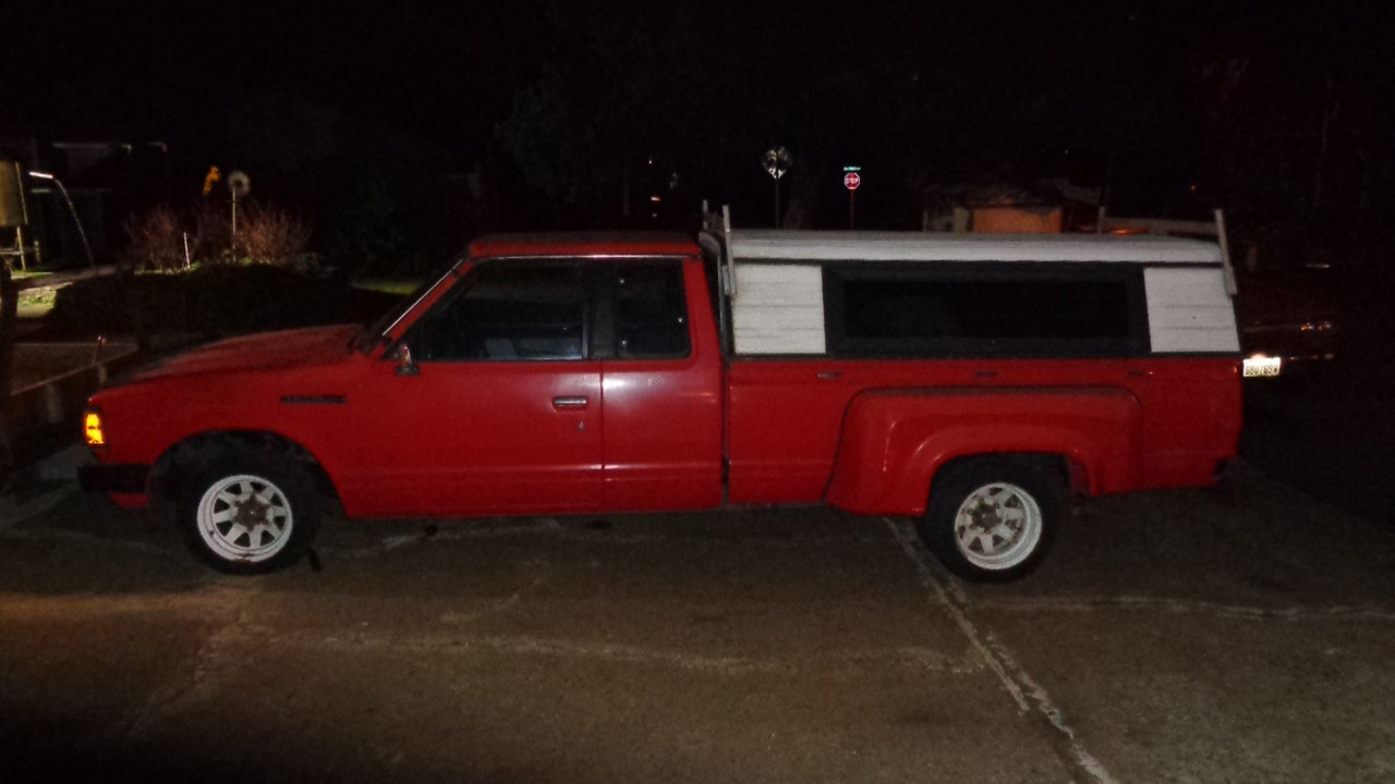

This truck is small compared to a full sized truck, but it can haul weight with these aftermarket dually wheels on it, but when I put the adapters on it and use real Nissan dually wheels/rims, I don't really haul weight as they are 2 1/8th inch adapters and had to be that thick for the dually wheels/rims to clear the leaf springs, but I will tow with it anytime.

I forgot to mention, you can see in the last side photo where the exhaust exits just under the drivers door, it's pretty loud exiting right there, I really could not hear much of anything at all but the exhaust while driving down the freeway even with the window rolled up, I do not have enough flex pipe to get any farther back and since I am going to have a exhaust shop make the exhaust I do not feel like buying anymore flex pipe.

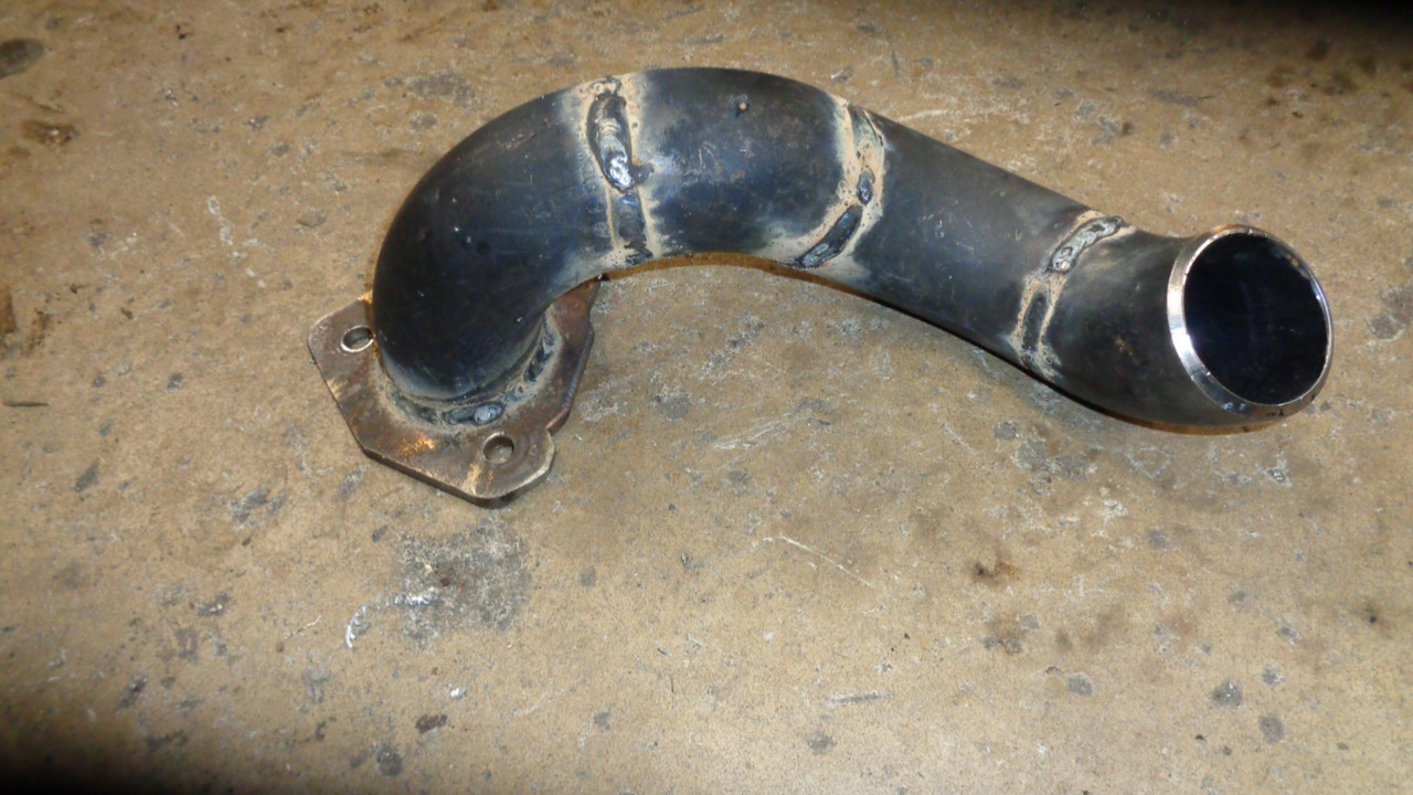

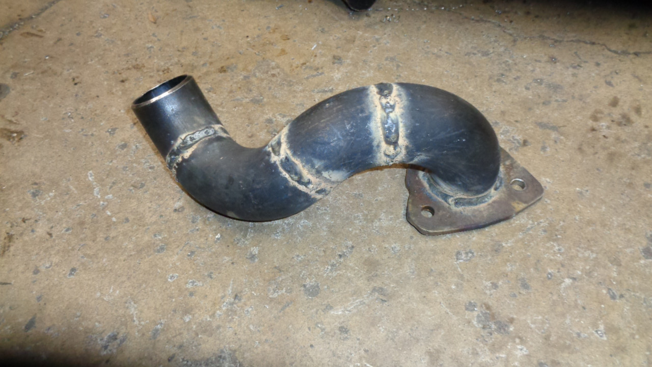

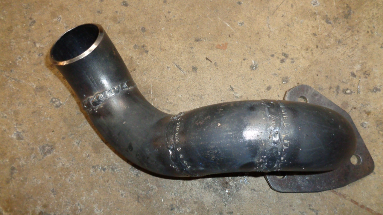

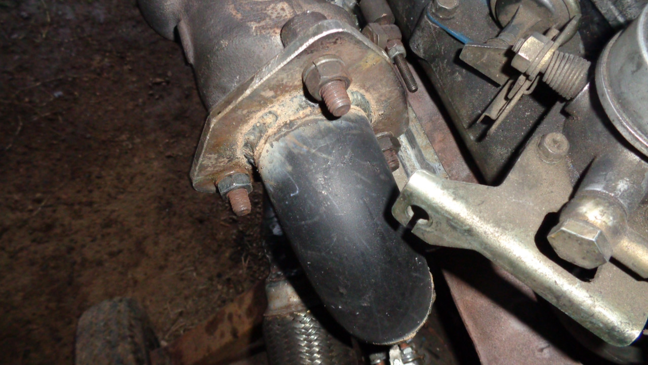

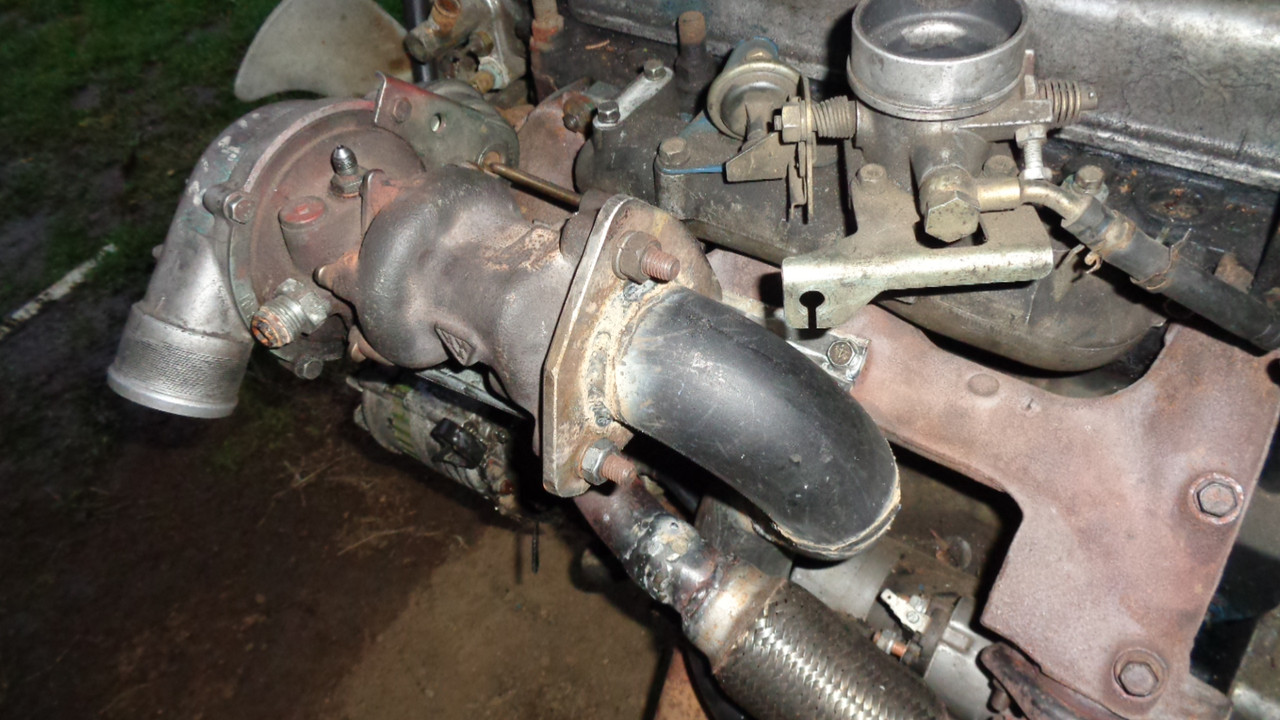

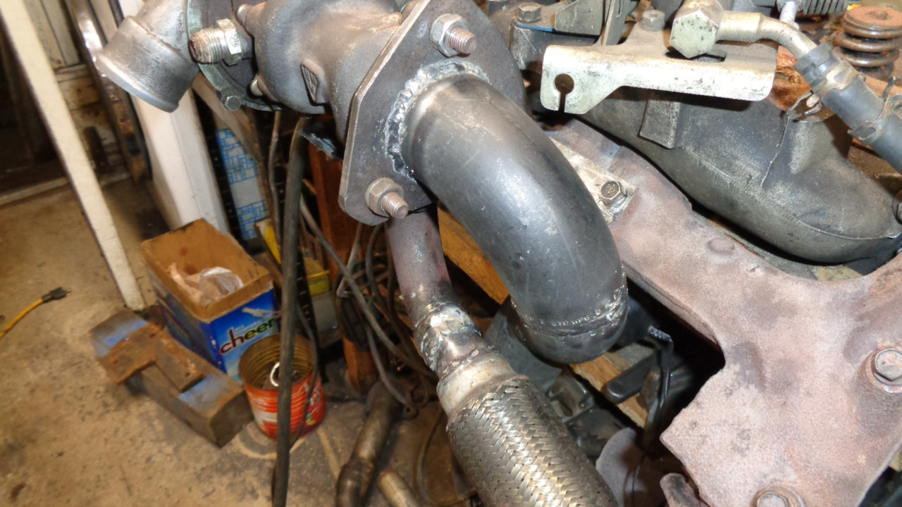

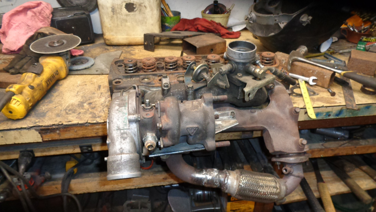

I also worked on the old turbo setup as it will likely be used by someone else, or me with a blow off valve.
I bought some pre-made elbows, two 90 degree elbows and two 45 degree elbows, I made the turbo head pipe this afternoon, I weld better when I can see and the metal is clean.

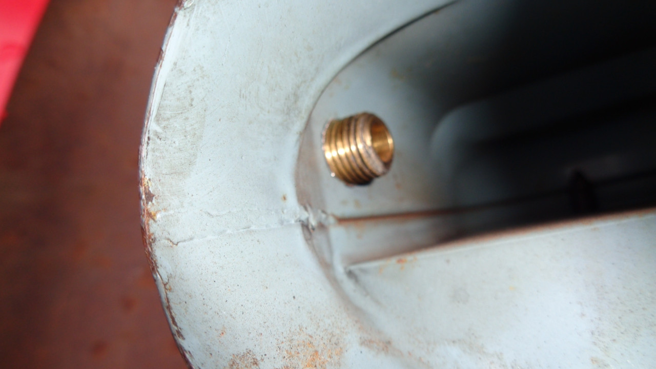

I bought this Volvo with this diesel engine from Larry, it had this propane injection setup on it.
I took the propane setup off so I would not have to deal with it while trying to get the engine to run properly, well it took a while but I finally figured it out and now all my diesel engines have turbochargers on them and they run great.
So I have been thinking about this propane injection, Larry put a lot of time and research into it, but I am kinda scared to install it as it is a totally different engine now, it even has a different turbo on it.
The way it is set up in the air filter is so simple it's scary, it's nothing more than a fitting end sticking inside the air filter neck.
I removed the filter top to get the photo, when I took it out I cleaned the filter also, when I removed the filter from the top and looked inside the filter the screening inside had collapsed inward, sorry I forgot to take a photo of that, so what I did was I added a much stiffer screen inside to stop it from collapsing.
Now I suppose I could add fittings to the inside to pipe it to the middle, and then put a 90 degree elbow on the end with a short piece of tubing on it pointed towards the turbocharger which will create a draft to pull air out of the tube creating a venturi type effect, it would likely pull more propane out that way, but keep in mind that I am not using the turbo that Larry was using either, it takes longer to build boost and it does not create the boost numbers that the turbo produced that was on it when Larry made this setup.
Larry also had the regulator set up with a bypass, sort of a primer, if I pressed the button in the middle of the regulator the idle noticeably went up(higher idle).
The turbocharger on it now is larger than the one Larry built, but Larry machined out the inside of the compressor side to except a larger vane in the smaller turbo(I still have that turbo), so the way I see it I am not moving the amount of air I was moving with Larrys turbocharger as that one was smaller so the exhaust side spun up easier/faster than the one on it now, but this is what I wanted as I wanted the boost PSI to be at 4/6psi driving down the freeway at 70mph and rise up to 12psi getting on the freeway or when I was passing someone rather than being at 12psi all the time no matter what road/freeway I was on with the turbo Larry had on the engine.
I wrote all this so anyone reading it would have all the info I could give them, it would be easy for me to install this propane system as I didn't pull it apart, I just removed the hose from the fitting on the air filter housing, disconnected it from the propane tank and I stored it in the back of the truck which has a canopy, it is all there.
I wrote/posted this on the Diesel Forums in the guys thread about this propane injection that came on the Volvo I bought from him that had this turbocharged diesel engine in it, tell me what you think, should I put the propane injection back on the engine.
Here is a link to the thread about it on that site if you want to read the whole thread, it's only one page and a couple replies long.
http://nissandiesel.dyndns.org/viewtopic.php?f=4&t=3410

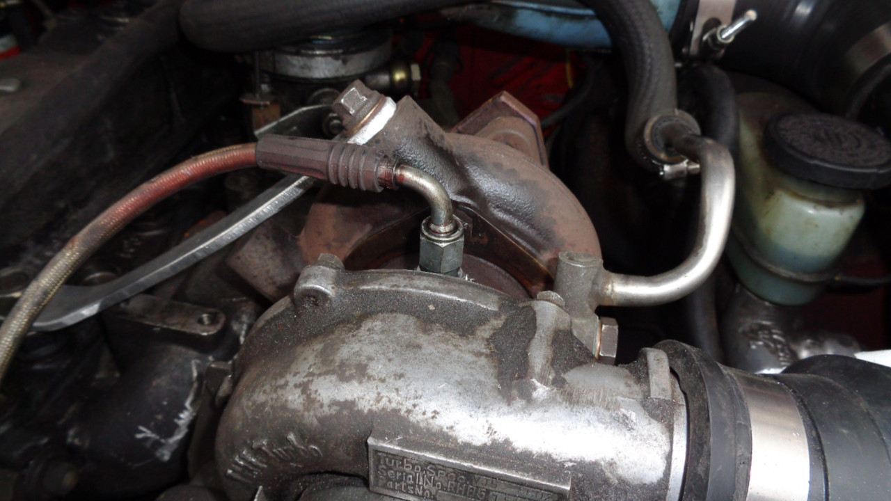

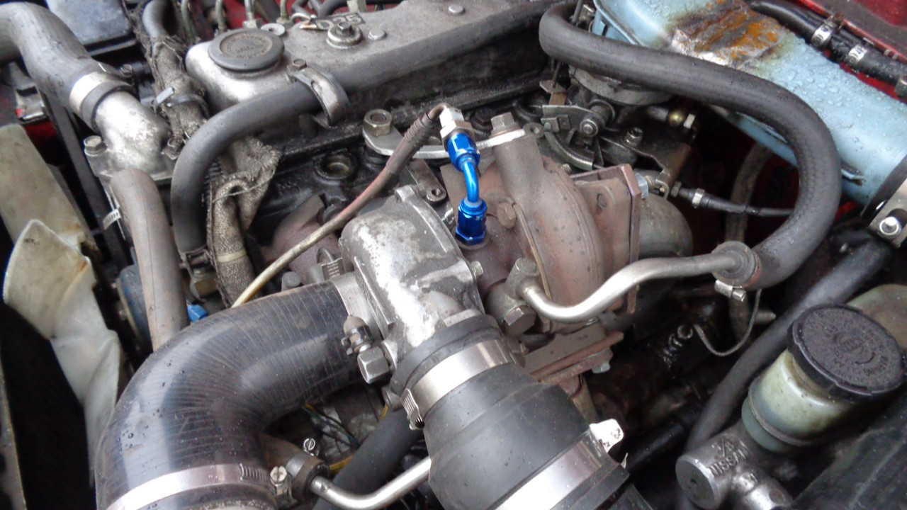

Today I went to "Oil Filter Services" and got the fitting I needed, this is before.
And this is now, I can press down on the hood and feel it is not hitting anymore.

They didn't have the type of fitting I brought as an example(out of stock) so he asked me how it sealed, I didn't have an answer, but I bought it and said if it had the wrong seat I would cut the end off if I had to and bevel it the other way.
But when I looked down the hole the fitting went into it had no seat at all, it was just a threaded hole like one that uses a banjo bolt and fitting with copper washers to seal it, I put lots of pipe tape on the threads and will watch it for oil leaks for a while.
I actually drove it today and gave it some real pedal, without anything rattling on anything and a better put together exhaust system I did today it went pretty good and sounded alright, it is louder than it has ever been before though, this turbo is not doing as good of a job quieting the exhaust as the other turbos I have used or are using, but the exhaust on it this time exits sideways behind the rear wheels, and before it dumped under the truck at the ground, while my 521 exhaust exits straight backwards.
