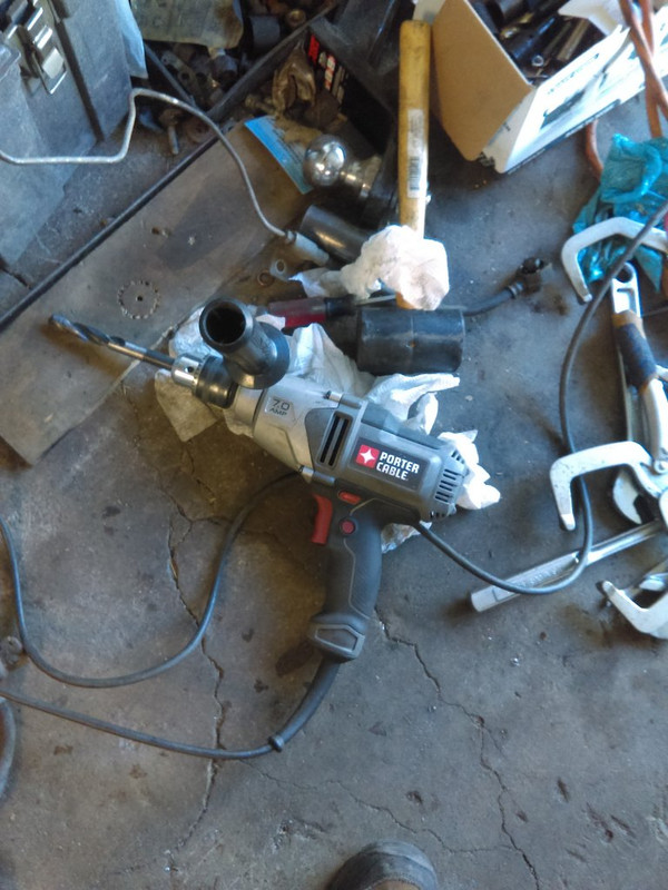

So the drill press couldn't do it it kept getting stuck so then I put it in the vise in the regular jaws. That obviously spun as you can see from the striations on the sleeve. So then I checked it up in the pipe gripping side and tightened it f****** hard. Even that was a pain in the ass because it just wants to take such a big bite even if you're going really slow. Probably would have helped to have just one more size to ring this out although it's not very far off it's definitely not a big cut.
Anyway now to make the other three. The outside surface won't matter anyways, I'll be welding to that not a big deal.
The pain in the butt is you have to start it in the drill press until it starts binding up and then transfer it to the drill. if the drill press was gear driven instead of belt driven it would probably go through it but it's not.
Two things: I found one of the adjustments for the motor on the drill press was loose so I moved the motor to tighten the belts and gosh that'll be better. And the last one I was drilling through went way crooked. The drill bit also wasn't grabbing so I chucked it up in the drill doctor and got that sharp again.
Just cut two more sleeves, I'll try again. A smidge off is okay but not a mile off.
So making four bushings only took 3 hours LOL. This is why I need a mini lathe. Plus we're off by 5 or 10,000 switch isn't going to matter that much but I could have had these exactly dead on with the lathe.
For some reason the drill press is being a turd I think it's because the base is deflecting as it tries to drill. I ruined two more sleeves in the process of making these four. Apparently the first two were dumb luck because they came out just fine. Then I drilled two more that were offset and not acceptable. And finally I started doing drill press on one side and then flipping it around and doing the other side and then when that didn't finally work I had gotten enough down where I could put the drill in it and go all the way through without doing it off center.
