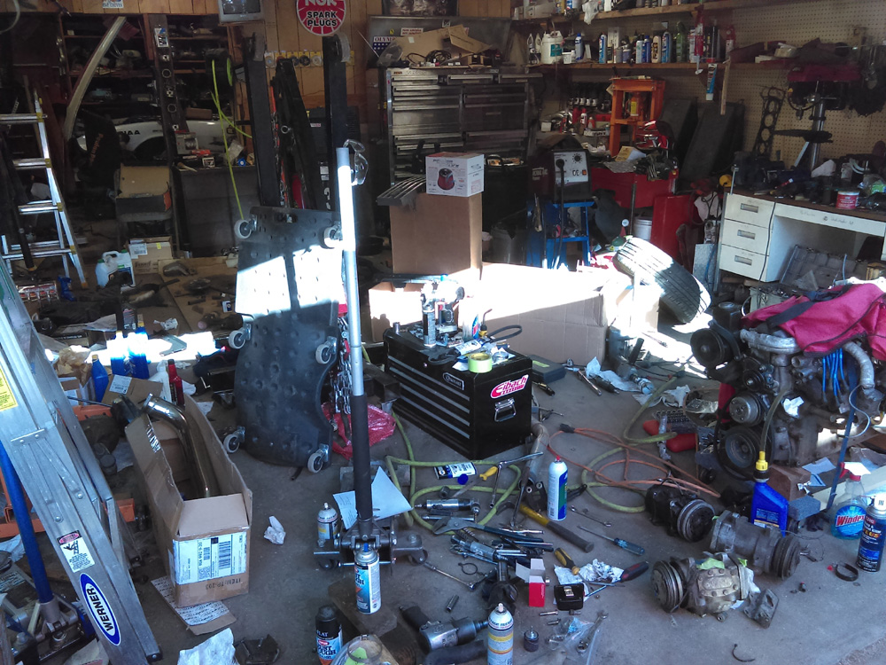

Car looks good.
Garage looks horrible.
Lol, every time I try to clean it I end up working too late and have to throw everything in and clean up to do something else.
Story of my life. Rest assured when I'm done with the wagon project, the garage will get a thorough day-long cleaning. It will need it.
My garage was definitely worse. It was a little bad before the engine swap on the BMW, but then I did that, and without much cleanup, went straight to the transmission rebuild. That was hard to recover from.
Floor is spotless now... and I am moving...
