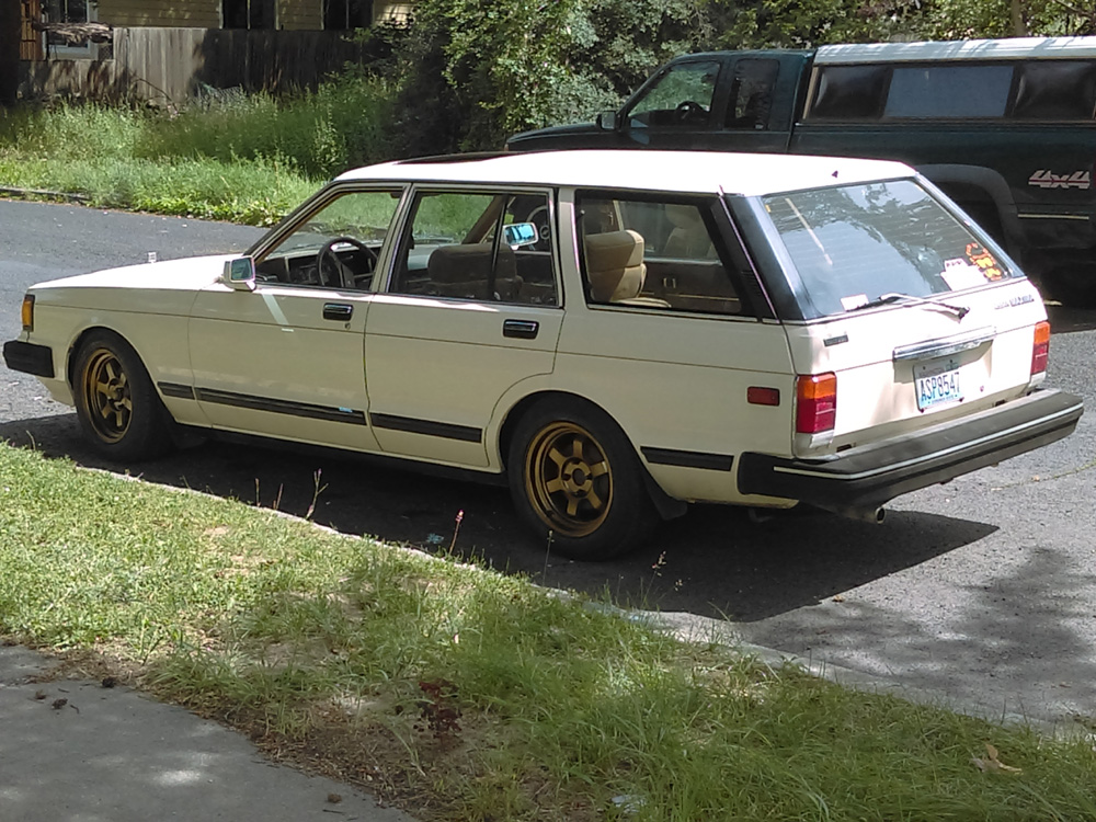

Re: Wynona the wagon's resurrection!
Thanks Wayno, it definitely doesn't have much down low, but once the turbo spools it pulls nicely. It seems to be quite long legged with the transmission as well. The transmission is the high point, it shifts like butter, way nicer than the original maxima trans. I imagine this will be really nice for highway cruising, should get low rpms.
Of course, I've yet to have it on the freeway. I did order a little bling for it. A chrome gts-t emblem, figure it'll be a nice touch on the liftgate. I'm definitely glad I hid the interviewer too, a big one would have just drawn attention. It's low, fast, and quiet. Perfect for a sleeper.
