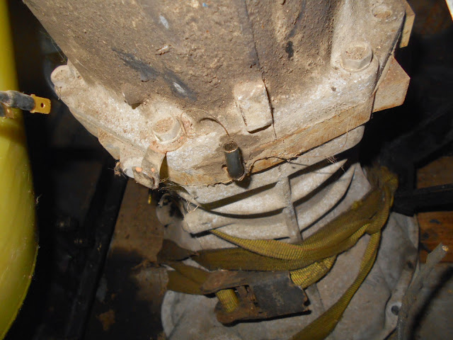

To much oil:
Re: soon to be LZ2.3 521 :)
#1168
Well there is definitely something spraying all over everything, and that is without a driveline connected, the seal isn't working, as that 521 yoke has a plug in the hole, correct?

The transmission vent is clear, correct?, you didn't plug it for any reason, correct?

Vent?

Didn't plug anything so me not know what the vent is doesn't really matter.
#1173
On the shortshaft it is located on the pancake between the alloy front and rear cases.
It's just a tube bent 90 degrees.
If it's leaking on the 521 yoke also, try another seal with a different part number, I heard there were 2 or 3 different ones.

Yeah that tube. I wondered what that was. No not plugged. Still bent in a 90 just like that.

When the seal is out, find a good light, and inspect that tailshaft, look for anything that looks like a crack, I hope for you it is just the seal being wrong.

You see the split? Crack whatever you wanna call it?
