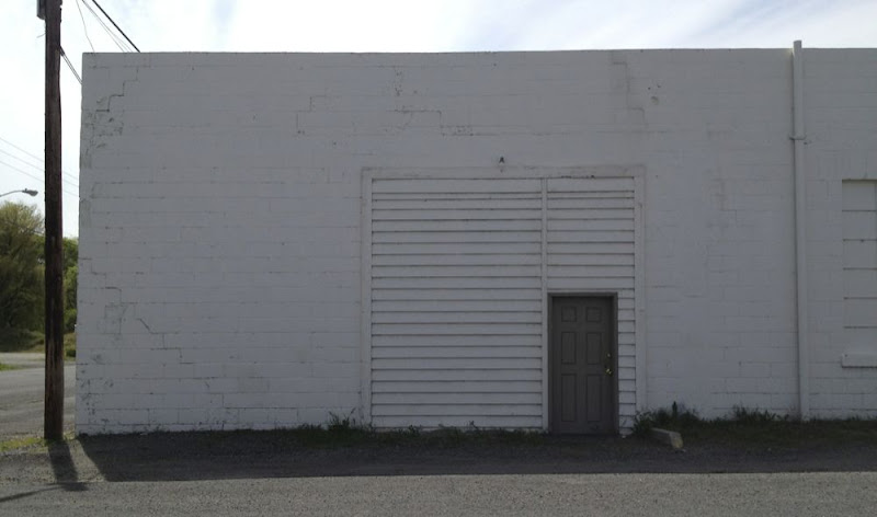

I moved out to central WA a year ago to take my dream job. I'm in a really small community. About 3000 people. Nearest stop light is about 60 miles away. You get the idea. Part of my plan when I moved here was to pursue my upholstery business in my off time. I need something to do or I'll hate it here. So, I rented a commercial space. It's the back half of two retail spaces. The roll up door had been walled over..
Two moving trucks, my 620 and my sentra were full to the gills on moving day.
This is what it looked like the day I moved in.. emptied two moving trucks is more like it.
